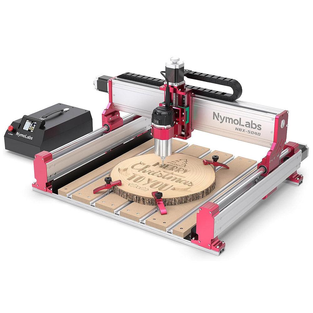

About the Machine
The NBX-5040 is NymoLabs' compact router, with a 508 x 408 x 97 mm working area, a 710W stepless spindle (7,000-30,000 RPM), NEMA23 steppers, and ball screws on every axis, with steel HSS linear tubes on the Y axis in place of a linear rail. It runs on open-source GRBL v1.1 with a 2.8 inch TFT touchscreen offline controller.

The NBX-5040's stepless spindle runs 7,000 to 30,000 RPM, covering the full range of the chart, on NEMA23 steppers with ball screws on every axis. Its Y axis rides on steel HSS linear tubes rather than the linear rail NymoLabs uses on the NBS-6040, so it's a step down in rigidity from that model. Take shallower passes here and build up gradually: push too deep and the bit deflects and chatters, leaving scalloped edges, or it rubs instead of cutting and burns the material. The fastest way to dial in a cut is to see what has already worked for other people.
Worked example for feed rate: 1/8in (3.175mm) two-flute solid carbide end mill in hard wood. The chart says 16,000 RPM, well within this spindle's 7,000-30,000 RPM range, so dial the knob to 16,000. With the bit maker's 0.025mm per tooth (0.0010 in): 16,000 x 0.025 x 2 = 800 mm/min (31 in/min) feed. For depth per pass, start shallow and check Community Cut Settings in Easel for what works on this machine. If the cut sounds strained, reduce the depth, not the feed. Slowing the feed below the chip load makes the bit rub instead of cut.

710W spindle, 7,000-30,000 RPM stepless (ER11 collet)
Stepper Motors
NEMA23, 76mm, 1.89 N.m, DM542 driver
Drive System
HG15 linear guide (X/Z), dual 20mm steel HSS linear tubes (Y), ball screws (1605 X/Y, 1204 Z)
