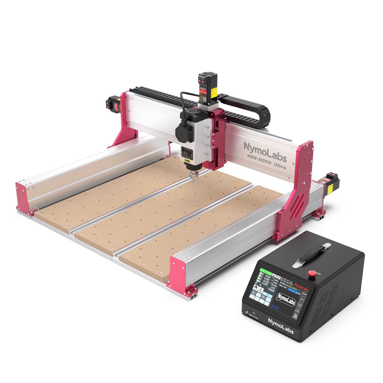

The NBS-6050 Ultra is NymoLabs' mid-size router, with a 615 x 504 x 117 mm (24.21 x 19.84 x 4.61 in) working area, a 2.2kW air-cooled spindle (0-18,000 RPM), NEMA24 closed-loop steppers, and linear rails with ball screws on every axis. It runs GRBL with a 7 inch HD touchscreen controller.

Quick Specs
Cuttable Area
Spindle Power
2.2kW air-cooled spindle (ER20 collet)
Stepper Motors
NEMA24 closed-loop, 3.5 N.m max torque, IP59
Drive System
Linear rails (HG15 X/Z, HG20 Y) and ball screws (1605 X/Y, 1204 Z)
Controller
GRBL
Connectivity
USB to computer, or standalone via 7-inch touchscreen controller
