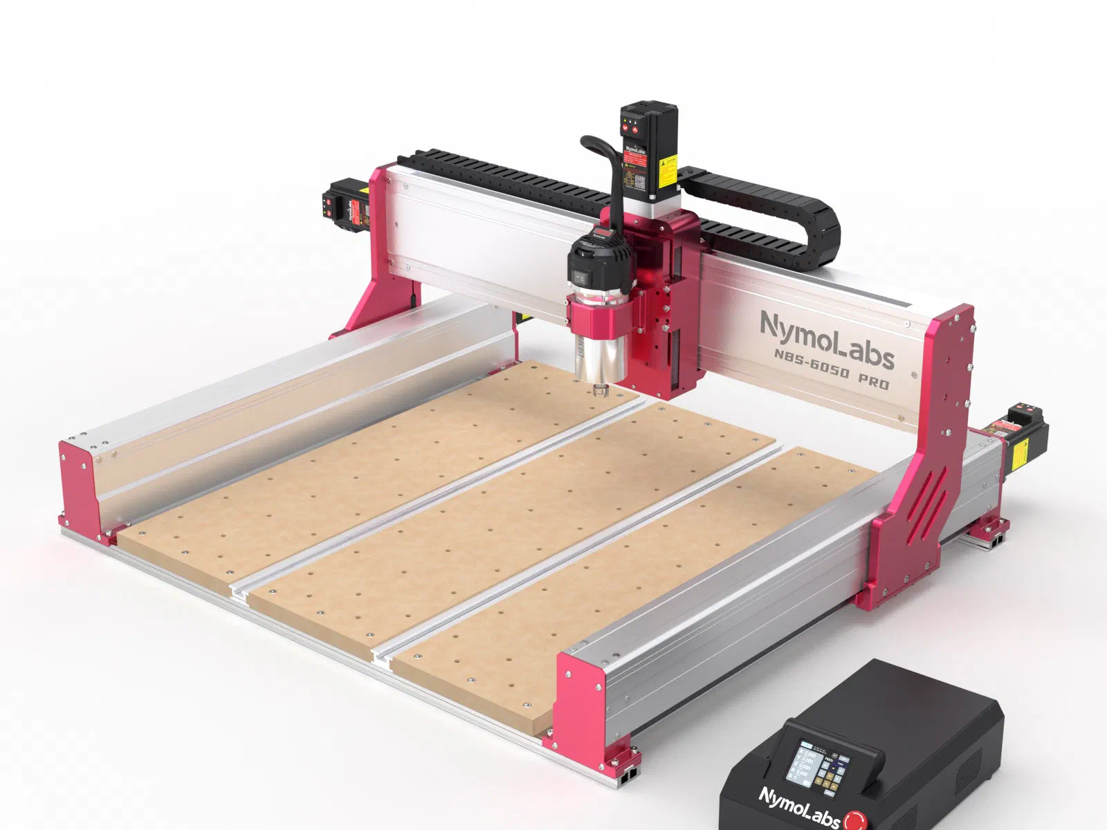

The NBS-6050 PRO is NymoLabs' mid-size router, with a 615 x 504 x 117 mm (24.21 x 19.84 x 4.61 in) working area, a 710W spindle (0-30,000 RPM) with a rotation speed display, NEMA24 closed-loop steppers, and ball screws with linear guides on every axis. It runs GRBL with a 2.8 inch TFT touchscreen offline controller.

Quick Specs
Cuttable Area
Spindle Power
710W spindle (ER11 collet)
Stepper Motors
NEMA24 closed-loop, 3.5 N.m max torque, IP59
Drive System
Ball screws (1605 X/Y, 1204 Z) with linear guides (HG15 X/Z, HG20 Y)
Controller
GRBL
Connectivity
USB or SD card, via 2.8-inch touchscreen (standalone)
