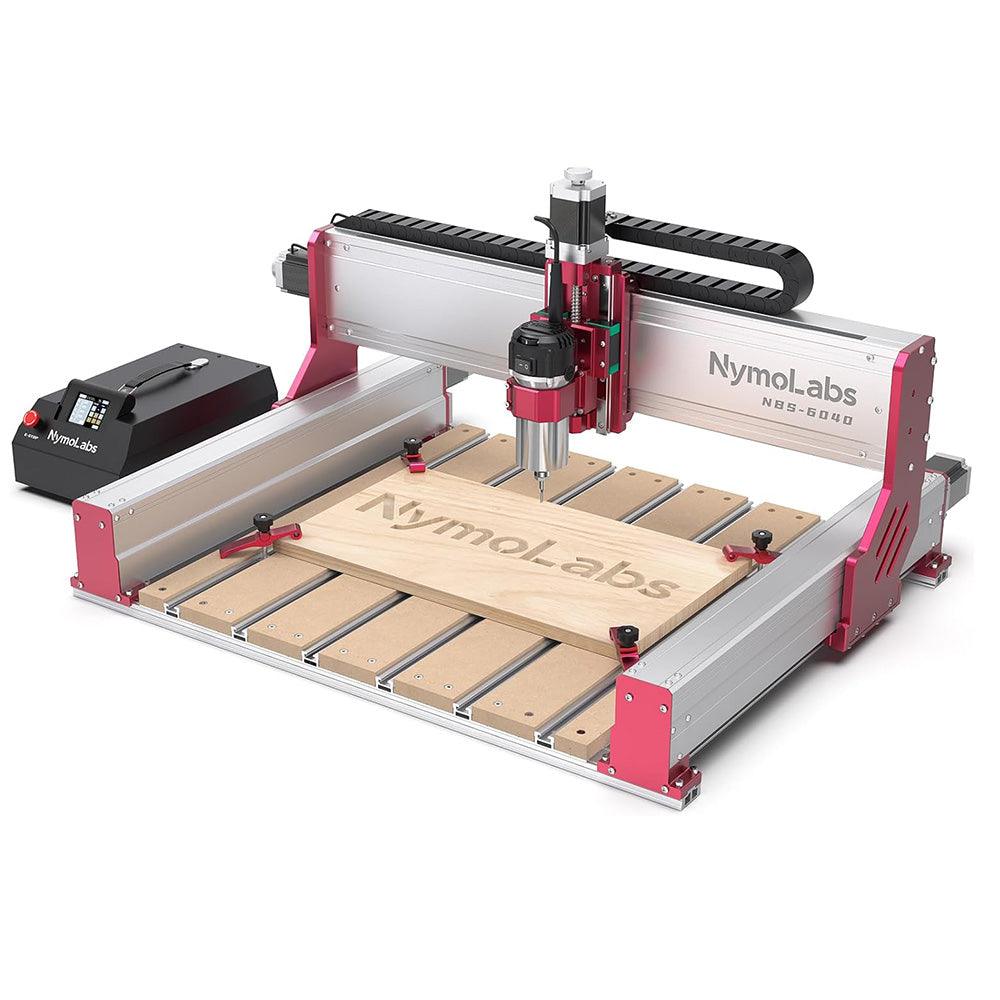

About the Machine
The NBS-6040 is NymoLabs' compact router, with a 610 x 410 x 120 mm working area, a 710W stepless spindle (7,000-30,000 RPM), NEMA23 steppers, and linear rails with ball screws on every axis. It runs on open-source GRBL v1.1 with a 2.8 inch TFT touchscreen offline controller.

Quick Specs
Cuttable Area
610 x 410 x 120 mm
Spindle Power
710W spindle, 7,000-30,000 RPM stepless (ER11 collet)
Stepper Motors
NEMA23, 76mm, 1.89 N.m, DM542 driver
Drive System
Linear rails (HG15 X/Z, HG20 Y) and ball screws (1605 X/Y, 1204 Z) on every axis
Controller
GRBL 1.1 (stock, 32-bit board, up to 80 kHz pulse; no board model stated)
Connectivity
USB (PC senders: Candle, gSender, Easel) or standalone via TFT touchscreen/SD
