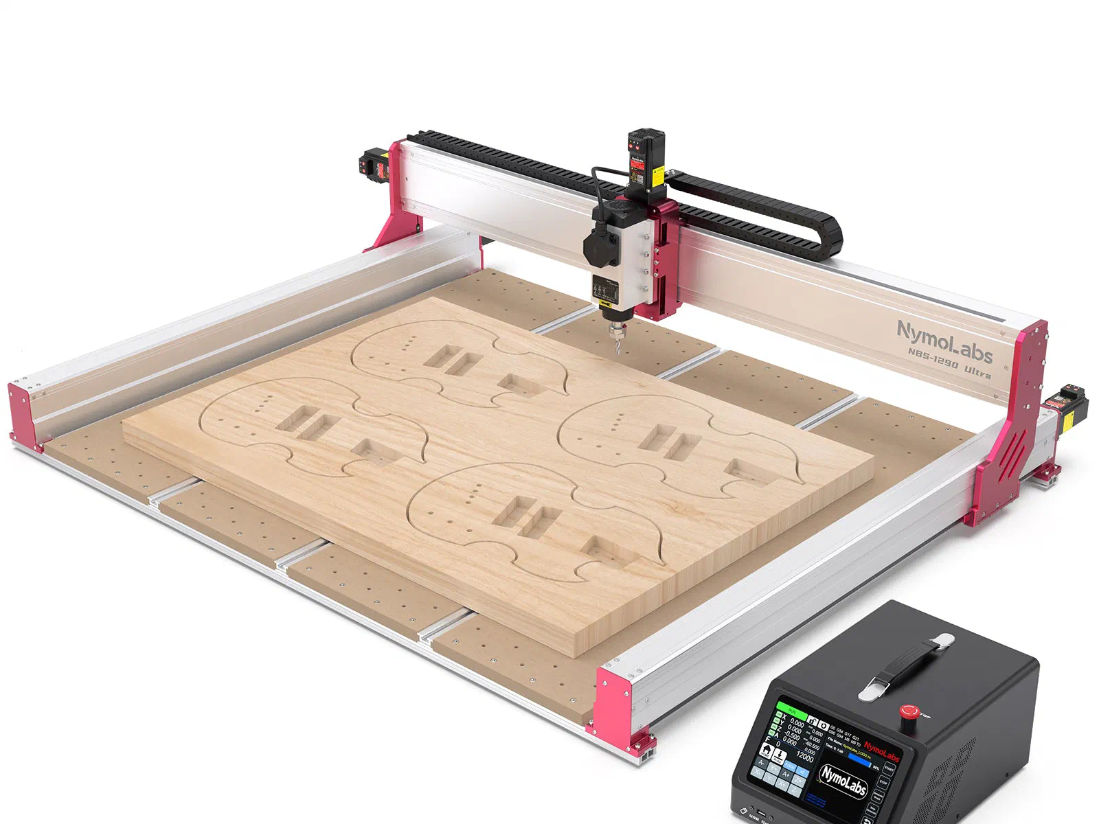

NymoLabs NBS-1290 Ultra machine photo

The NBS-1290 Ultra is NymoLabs' flagship large-format router, with a 1238 x 928 x 118 mm (48.74 x 36.54 x 4.65 in) working area, a 2.2kW air-cooled spindle (0-18,000 RPM), NEMA24 closed-loop steppers, and linear rails with ball screws on every axis. It runs GRBL.
