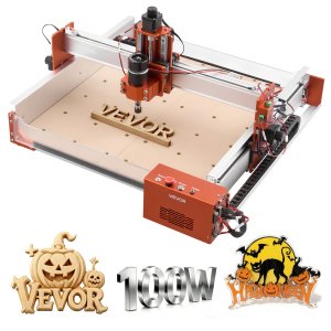

The 4040 CNC Router Machine, 100W has a 400 x 400 x 95mm (15.75 x 15.75 x 3.74 in) working area and a 100W spindle running 10,000 RPM. Its Z-axis rides on a linear rail; Vevor does not state the X/Y-axis drive system or a stepper motor spec.

This spindle is rated at 100W and runs at 10,000 RPM, below most of the chart. A spindle this small loses most of its torque at top speed, so leave it running at its rated speed and control the cut with feed rate instead. Depth per pass is where the machine's build matters. A truly rigid machine with a powerful spindle can cut as deep as the bit is wide in a single pass, but that takes real spindle torque, a drive train and clamps that hold firm, a gantry that will not flex, and enough mass to soak up vibration. Vevor states a Z-axis linear rail but does not publish the X/Y-axis drive system or a stepper motor spec, so treat this as a light-to-mid desktop machine and take shallow passes. Push too deep and the bit deflects and chatters, leaving scalloped edges, or it rubs instead of cutting and burns the material. The fastest way to dial in a cut is to see what has already worked for other people.
Worked example for feed rate: 1/8in (3.175mm) two-flute solid carbide end mill in hard wood. The chart says 16,000 RPM, but this spindle tops out at 10,000 RPM, so run 10,000. With the bit maker's 0.025mm per tooth (0.0010 in): 10,000 x 0.025 x 2 = 500 mm/min (20 in/min) feed. For depth per pass, start shallow and check Community Cut Settings in Easel for what works on this machine. If the cut sounds strained, reduce the depth, not the feed. Slowing the feed below the chip load makes the bit rub instead of cut.
