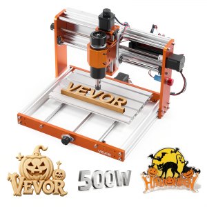

The 3018 CNC Router Machine, 500W Enhanced has a 300 x 180 x 80mm (11.81 x 7.08 x 3.15 in) working area and a 500W spindle rated at 12,000 RPM, with an extended 80mm Z-axis stroke for thicker material. Vevor does not state a stepper motor spec or a drive system for this machine.
