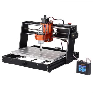

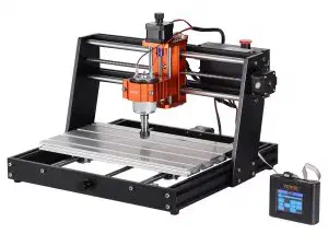

Vevor CNC Router Machine, 120W machine photo
About the Machine
Vevor no longer sells this model, but it remains fully supported in Easel. The 120W CNC Router Machine has a 300 x 200 x 72mm (11.81 x 7.87 x 2.83 in) working area and a 120W spindle (75W rated) running at 10,118 RPM. Vevor does not state a stepper motor spec or drive system for this machine.

Quick Specs
Cuttable Area
300 x 200 x 72 mm (11.81 x 7.87 x 2.83 in)
Spindle Power
Stepper Motors
Drive System
Controller
GRBL 1.1
Connectivity
USB, or standalone via built-in 2.4" offline controller (rotary knob)
