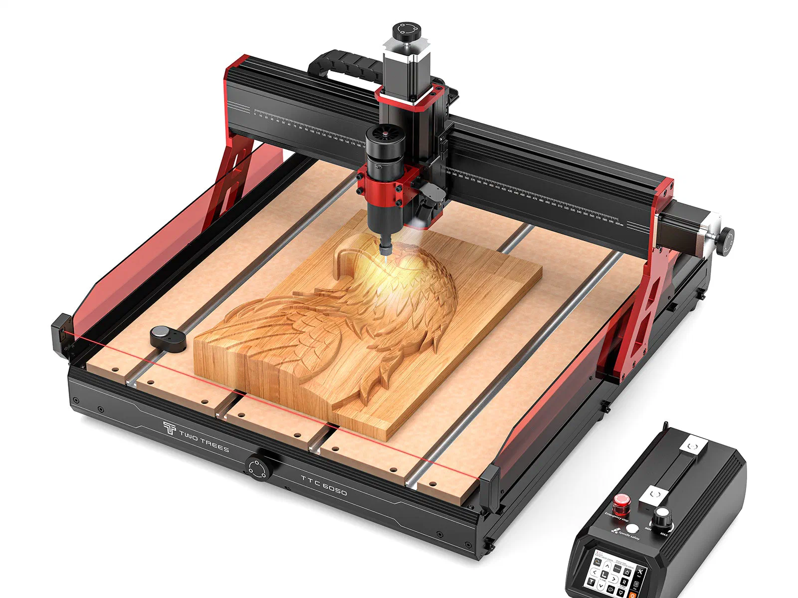

Two Trees TTC6050 CNC machine photo
About the Machine
The TTC6050 CNC is Two Trees' largest desktop router, with a 600 x 500 x 100mm (23.6 x 19.6 x 3.9 in) working area. It runs a 500W spindle motor at up to 12,000 RPM, driven by linear guides and ball screws on all three axes.
