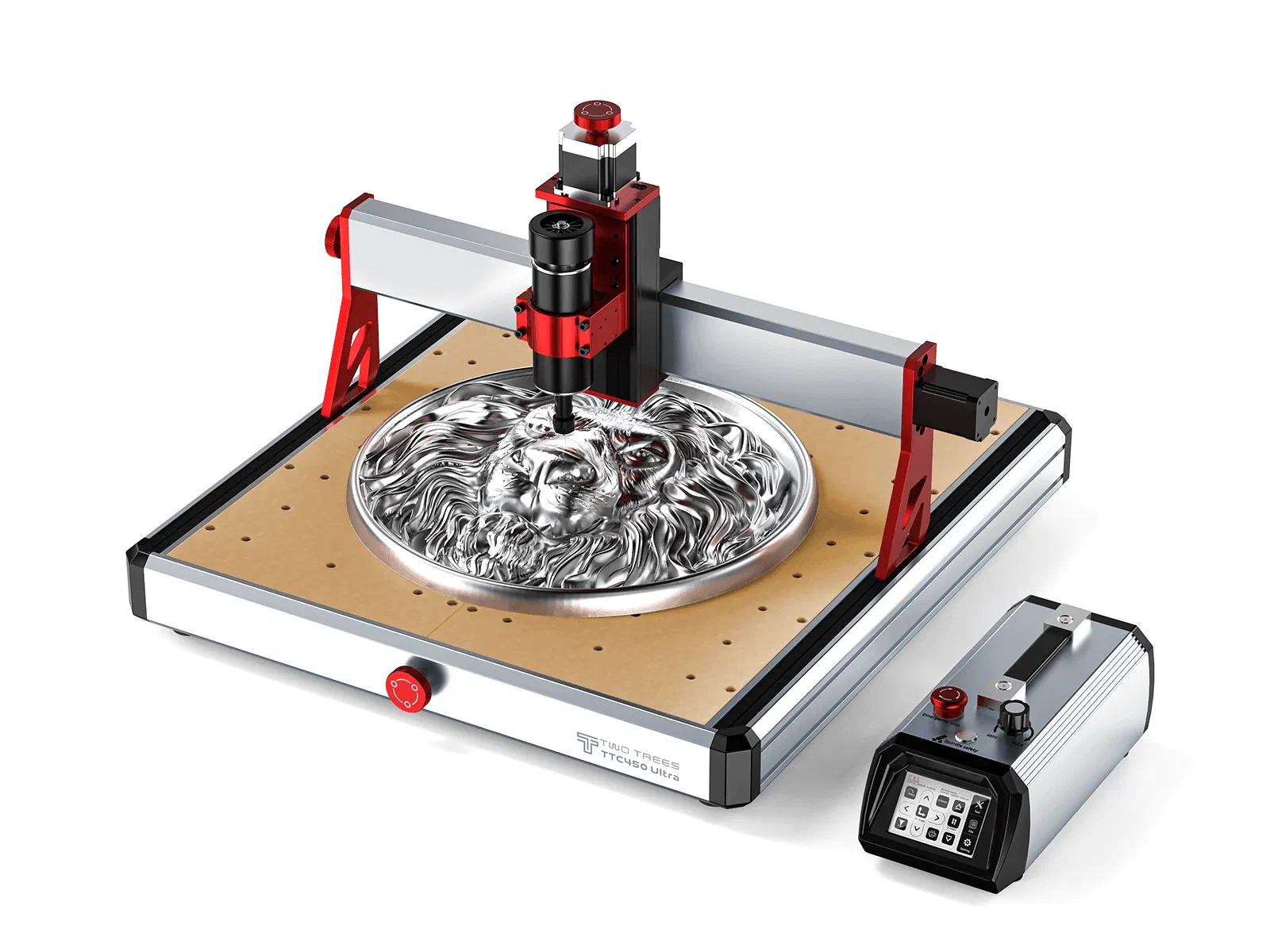

Two Trees TTC450 Ultra machine photo
About the Machine
The TTC450 Ultra is Two Trees' 460 x 460 x 100mm (18.11 x 18.11 x 3.94 in) desktop router. It ships with a 500W spindle stated to run 8,000 to 30,000 RPM depending on installation, and it rides on dual 12H linear rails for rigidity, controlled by GRBL.
