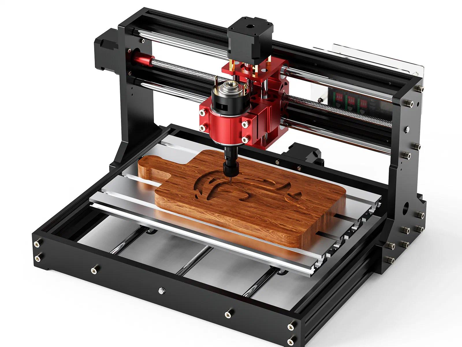

The TTC3018 Pro CNC Router Machine is Two Trees' upgraded version of the TTC3018, with a 300 x 180 x 40mm working area. It uses a T8 4mm lead screw drive on all axes and an upgraded metal Z-axis module for added rigidity over the base TTC3018, controlled by GRBL. Two Trees does not publish a spindle wattage or stepper motor model for this machine.

Two Trees does not publish a spindle wattage or maximum RPM for the TTC3018 Pro, so check the plate on your spindle before you start. This machine's metal Z-axis module adds rigidity over the base TTC3018's plastic Z-axis, but it still rides on a T8 lead screw, so it does not have the stiffness of a machine on linear rails and ball screws. Depth per pass is where that shows up: a truly rigid machine with a powerful spindle can cut as deep as the bit is wide in a single pass, but that takes real spindle torque, a drive train and clamps that hold firm, a gantry that will not flex, and enough mass to soak up vibration. This machine falls short of that bar, so take shallower passes. Push too deep and the bit deflects and chatters, leaving scalloped edges, or it rubs instead of cutting and burns the material. The fastest way to dial in a cut is to see what has already worked for other people.
Worked example for feed rate: 1/8in (3.175mm) two-flute solid carbide end mill in hard wood. The chart says 16,000 RPM. Two Trees does not state a maximum RPM for this spindle, so check the plate on yours and use its actual top speed in place of 16,000 if it is lower. With the bit maker's 0.025mm per tooth (0.0010 in): 16,000 x 0.025 x 2 = 800 mm/min (31 in/min) feed. For depth per pass, start shallow and check Community Cut Settings in Easel for what works on this machine. If the cut sounds strained, reduce the depth, not the feed. Slowing the feed below the chip load makes the bit rub instead of cut.

The TTC3018 Pro CNC Router Machine runs Grbl_ESP32 firmware, not published by Two Trees but confirmed independently. Easel's live control, the Easel Driver and Rapid Connect, works with classic GRBL and FluidNC over USB, so it does not carve this machine in real time. Use Easel to design and generate toolpaths, then export the G-code and run it from the machine's own controller over its built-in WiFi, TF card, or USB, using the ESP3D web interface or SD card. Because Easel's G-code is standard GRBL, it runs as-is on this controller. Select TTC3018 Pro CNC Router Machine in Easel's machine menu to size the canvas to its 300 x 180 x 40mm working area.
