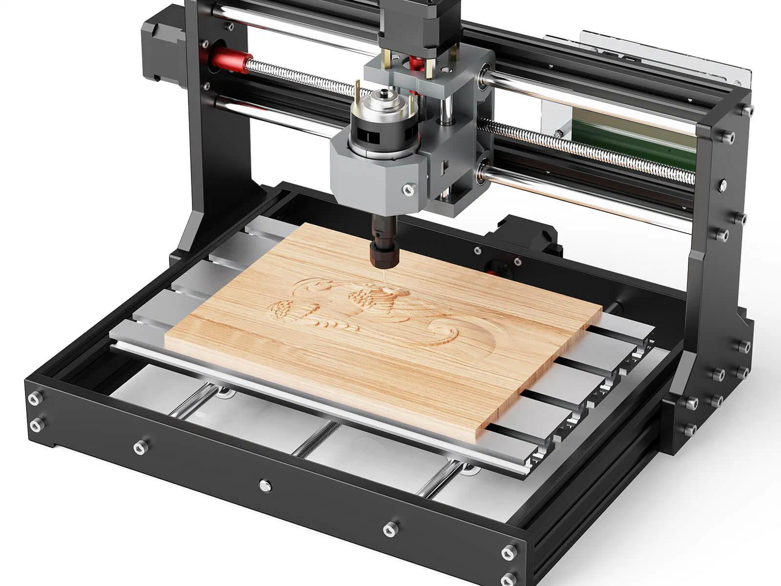

The TTC3018 CNC is Two Trees' entry-level desktop router, with a 300 x 180 x 40mm working area. It runs on a NEMA17 stepper motor and a T8 4mm lead screw drive on all axes, controlled by GRBL over USB. Two Trees does not publish a spindle wattage or model for this machine.

Two Trees does not publish a spindle wattage or maximum RPM for the TTC3018, so check the plate on your spindle before you start. A light desktop machine like this one, riding on a T8 lead screw and a NEMA17 stepper, does not have the rigidity or torque of a larger router. Depth per pass is where that shows up: a truly rigid machine with a powerful spindle can cut as deep as the bit is wide in a single pass, but that takes real spindle torque, a drive train and clamps that hold firm, a gantry that will not flex, and enough mass to soak up vibration. This machine falls short of that bar, so take shallower passes. Push too deep and the bit deflects and chatters, leaving scalloped edges, or it rubs instead of cutting and burns the material. The fastest way to dial in a cut is to see what has already worked for other people.
Worked example for feed rate: 1/8in (3.175mm) two-flute solid carbide end mill in hard wood. The chart says 16,000 RPM. Two Trees does not state a maximum RPM for this spindle, so check the plate on yours and use its actual top speed in place of 16,000 if it is lower. With the bit maker's 0.025mm per tooth (0.0010 in): 16,000 x 0.025 x 2 = 800 mm/min (31 in/min) feed. For depth per pass, start shallow and check Community Cut Settings in Easel for what works on this machine. If the cut sounds strained, reduce the depth, not the feed. Slowing the feed below the chip load makes the bit rub instead of cut.
