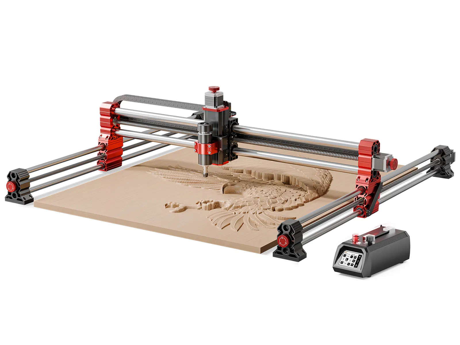

About the Machine
The TTC-H40 is Two Trees' large-format router, with a 1000 x 1000 x 100mm (39.4 x 39.4 x 4 in) working area. It ships with a 500W spindle stated to run 8,000 to 30,000 RPM depending on installation, and it moves on trapezoidal lead screws on its X and Y axes and linear rails on the Z axis, controlled by GRBL.

Quick Specs
Cuttable Area
1000 x 1000 x 100 mm (39.4 x 39.4 x 4 in)
Spindle Power
500W spindle, BLDC4475 brushless motor (8,000-30,000 RPM depending on installation); optional 800W/2000W/3000W AC trimmer
Stepper Motors
Nema 23 stepper motors
Drive System
Trapezoidal lead screws on X/Y (16 mm screws on 20/30 mm tube rails; lead screws, not ball screws, per the manufacturer's comparison note); linear rails on the Z axis
Controller
GRBL
Connectivity
USB, TF card, or standalone via onboard touchscreen
