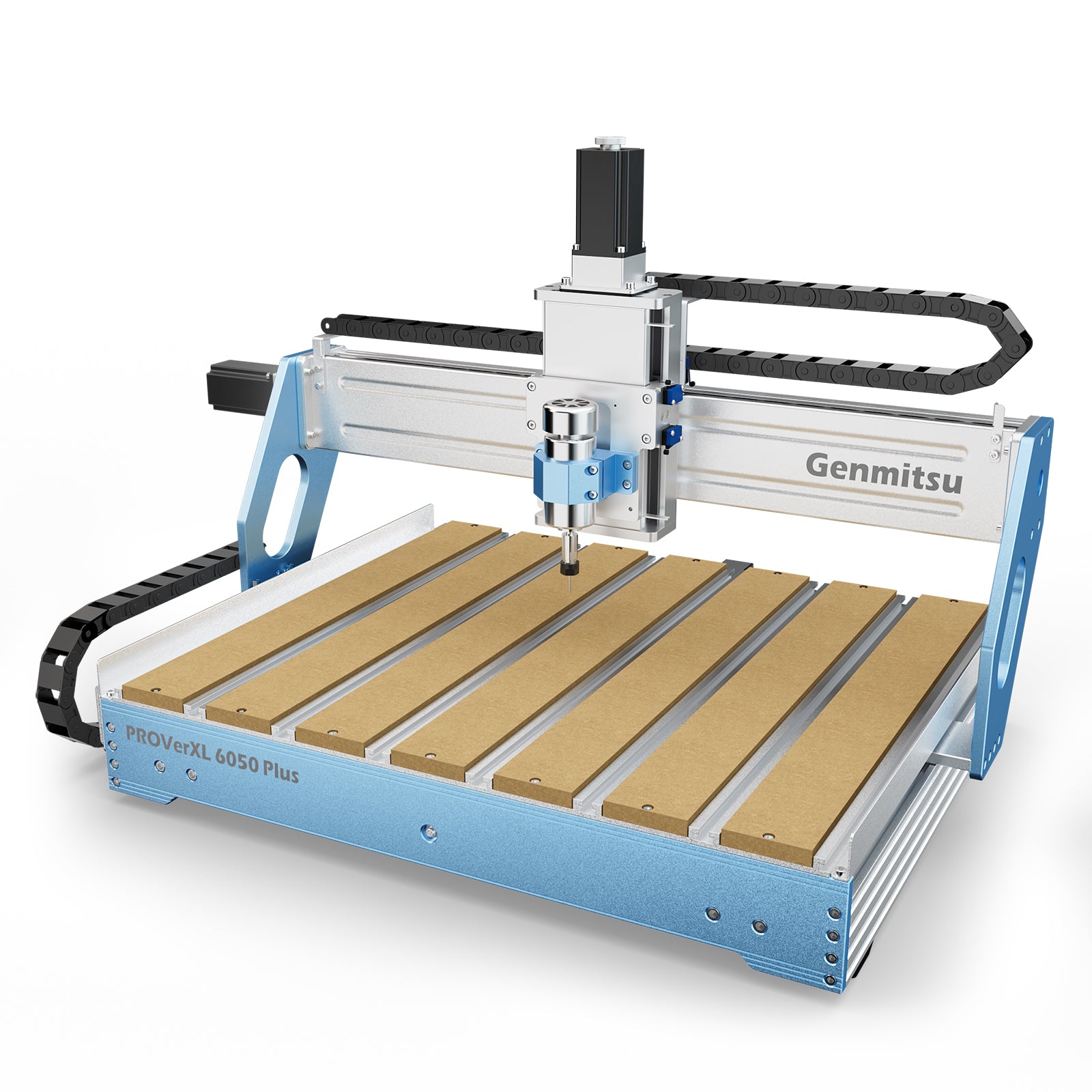

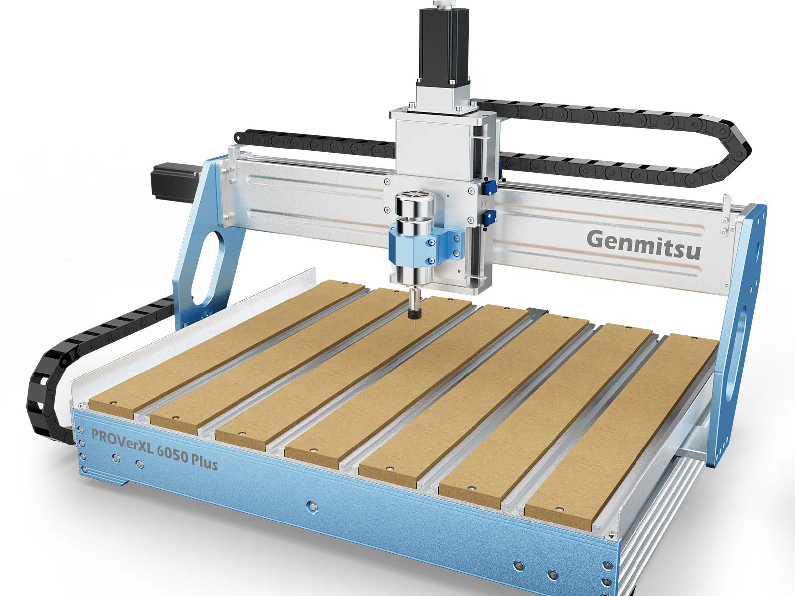

SainSmart Genmitsu PROVerXL 6050 Plus machine photo
About the Machine
The Genmitsu PROVerXL 6050 Plus has a 600 x 500 x 115 mm working area, a 300W spindle (0-48VDC, 12,000 RPM), and open-loop NEMA23 stepper motors (3.1 Nm torque) on a dual linear rail and lead screw structure.

The PROVerXL 6050 Plus's 300W spindle tops out at 12,000 RPM, near the middle of the chart. It has more torque than a small brushed 775 motor, so favor the middle of its range for hard materials and push toward 12,000 for softer ones. Depth per pass is where the machine itself matters. A truly rigid machine with a powerful spindle can cut as deep as the bit is wide in a single pass, but that takes real spindle torque, a drive train and clamps that hold firm, a gantry that will not flex, and enough mass to soak up vibration. NEMA23 steppers on a dual linear rail and lead screw structure give this machine more stiffness than SainSmart's smaller kits, but its large 600 x 500 mm working area is more prone to flex at the extremes, so keep passes moderate. Push too deep and the bit deflects and chatters, leaving scalloped edges, or it rubs instead of cutting and burns the material. The fastest way to dial in a cut is to see what has already worked for other people.
Worked example for feed rate: 1/8in (3.175mm) two-flute solid carbide end mill in hard wood. The chart says 16,000 RPM, but this spindle tops out at 12,000 RPM, so run 12,000. With the bit maker's 0.025mm per tooth (0.0010 in): 12,000 x 0.025 x 2 = 600 mm/min (24 in/min) feed. For depth per pass, start shallow and check Community Cut Settings in Easel for what works on this machine. If the cut sounds strained, reduce the depth, not the feed. Slowing the feed below the chip load makes the bit rub instead of cut.

Cuttable Area
600 x 500 x 115 mm (23.6 x 19.7 x 4.5 in)
Spindle Power
Stepper Motors
NEMA23, open-loop, 3.1 Nm
Drive System
Dual linear rail and lead screw structure
Controller
GRBL 1.1h
Connectivity
USB
