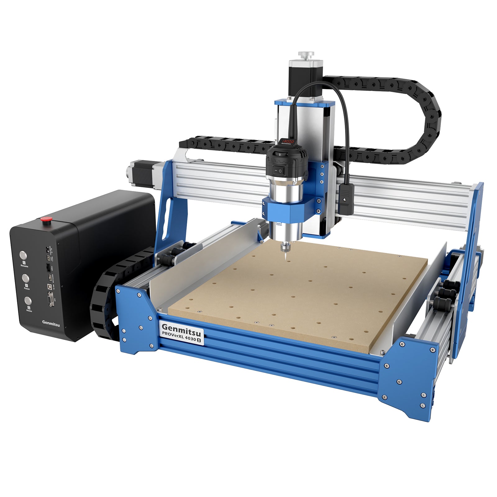

The Genmitsu PROVerXL 4030S has a 400 x 300 x 120 mm working area, a 710W spindle with an adjustable 6,500 to 30,000 RPM range, and open-loop NEMA23 stepper motors (57mm).

The PROVerXL 4030S's spindle adjusts from 6,500 to 30,000 RPM, which covers the entire chart, so dial it to whatever the chart recommends for the material and bit rather than leaving it pinned at max. Depth per pass is where the machine itself matters. A truly rigid machine with a powerful spindle can cut as deep as the bit is wide in a single pass, but that takes real spindle torque, a drive train and clamps that hold firm, a gantry that will not flex, and enough mass to soak up vibration. This machine has real spindle power, but its Z-axis is a T-screw and linear guide and its X/Y axes ride on a T-screw and wheel system rather than ball screws, so it falls short of that top rigidity tier. Keep passes moderate rather than pushing full bit-width depth. Push too deep and the bit deflects and chatters, leaving scalloped edges, or it rubs instead of cutting and burns the material. The fastest way to dial in a cut is to see what has already worked for other people.
Worked example for feed rate: 1/8in (3.175mm) two-flute solid carbide end mill in hard wood. The chart says 16,000 RPM, and this spindle's adjustable range covers that, so dial it to 16,000. With the bit maker's 0.025mm per tooth (0.0010 in): 16,000 x 0.025 x 2 = 800 mm/min (31 in/min) feed. For depth per pass, start shallow and check Community Cut Settings in Easel for what works on this machine. If the cut sounds strained, reduce the depth, not the feed. Slowing the feed below the chip load makes the bit rub instead of cut.
