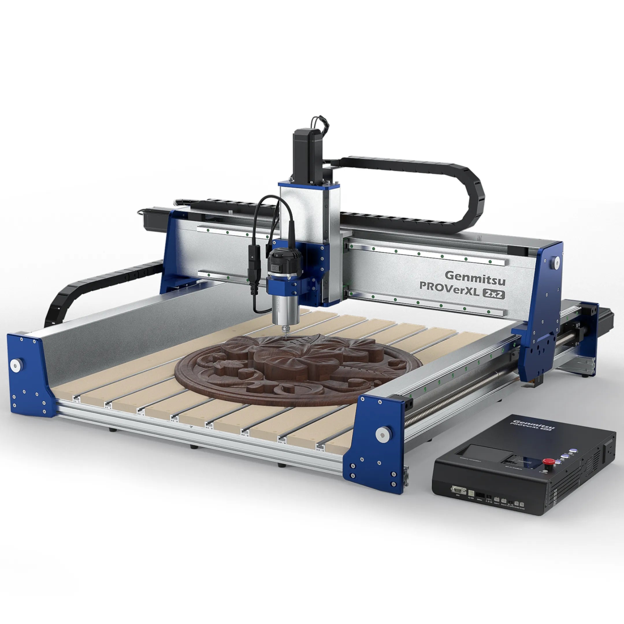

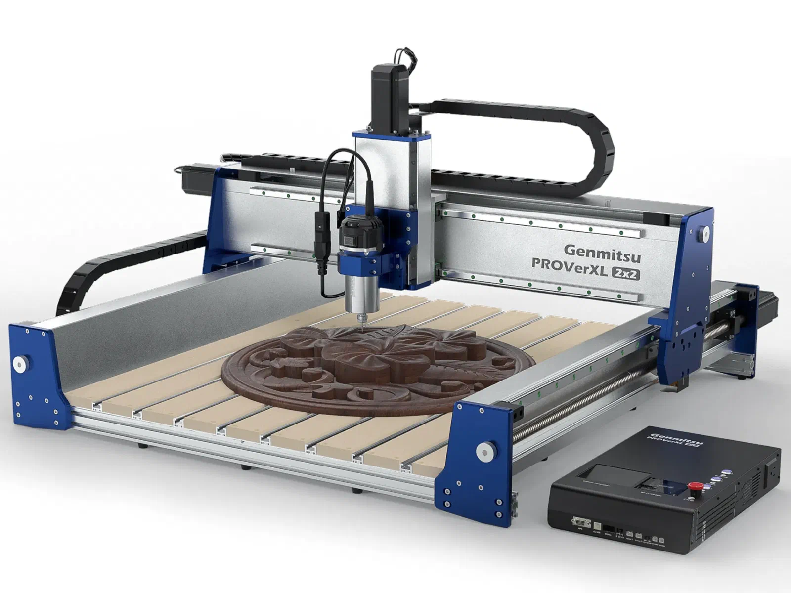

Sainsmart Genmitsu PROVerXL 2x2 machine photo
About the Machine
The Genmitsu PROVerXL 2x2 has a 679 x 679 x 113 mm working area, a 710W spindle (30,000 RPM, water-cooled spindle optional), and four closed-loop NEMA23 stepper motors (3.5 Nm torque) on linear guides with ball screws.
