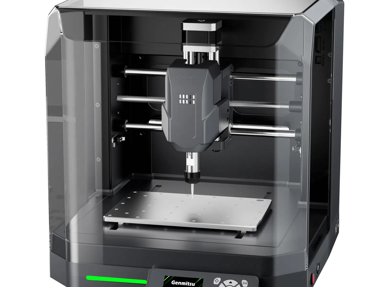

SainSmart Genmitsu Cubiko CNC Router machine photo
About the Machine
The Cubiko CNC Router has a 150 x 110 x 40 mm working area (58 mm Z gantry clearance), a 75W spindle (10,000 RPM max), and NEMA 17 stepper motors on an 8mm lead screw drive.
