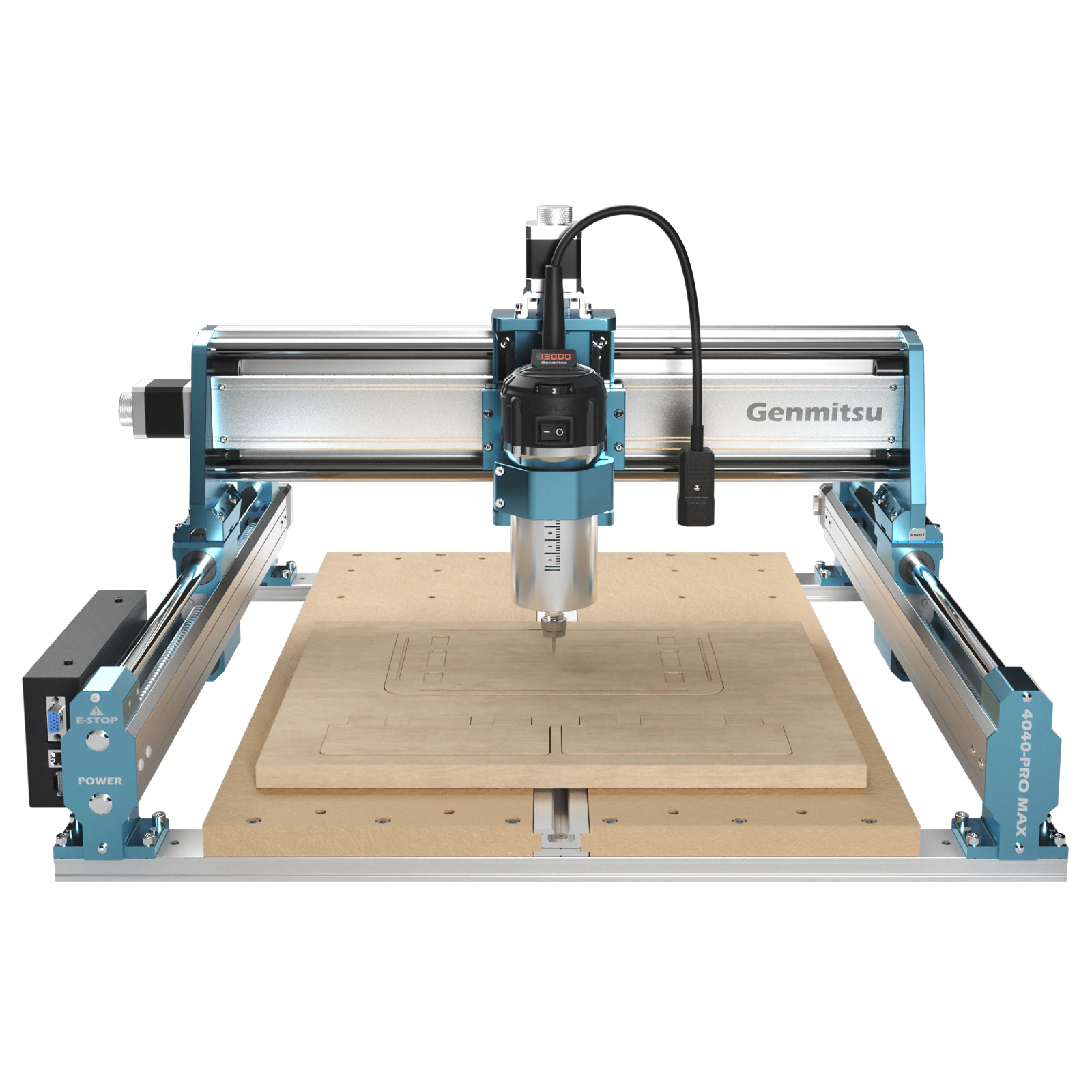

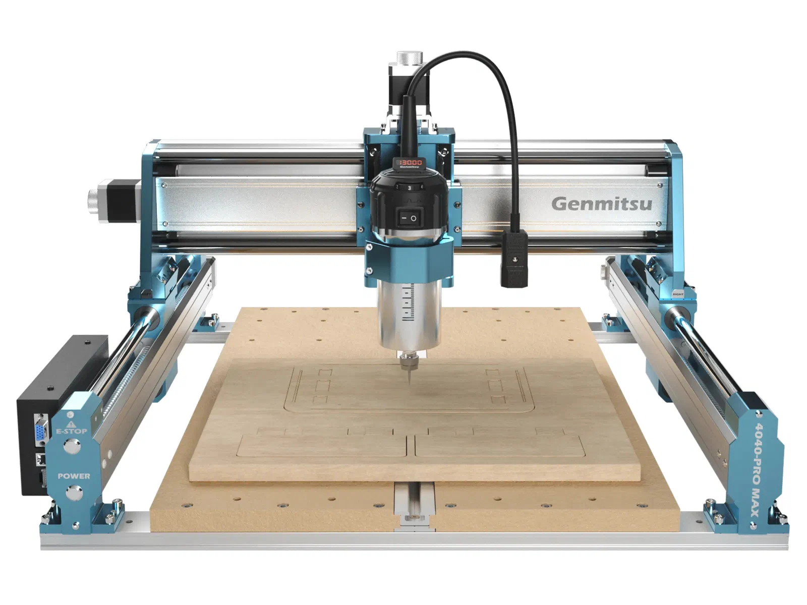

SainSmart Genmitsu 4040-PRO MAX machine photo
About the Machine
The Genmitsu 4040-PRO MAX has a 400 x 400 x 78 mm working area, a 710W digital trimmer router with an adjustable 6,500 to 30,000 RPM range, and NEMA17 stepper motors.

Quick Specs
Cuttable Area
400 x 400 x 78 mm (15.75 x 15.75 x 3.1 in)
Spindle Power
710W digital trimmer router, adjustable 6,500-30,000 RPM
Stepper Motors
NEMA17
Drive System
Lead screw (Y), linear optical-axis rail (X), linear guide rail (Z)
Controller
GRBL
Connectivity
USB
