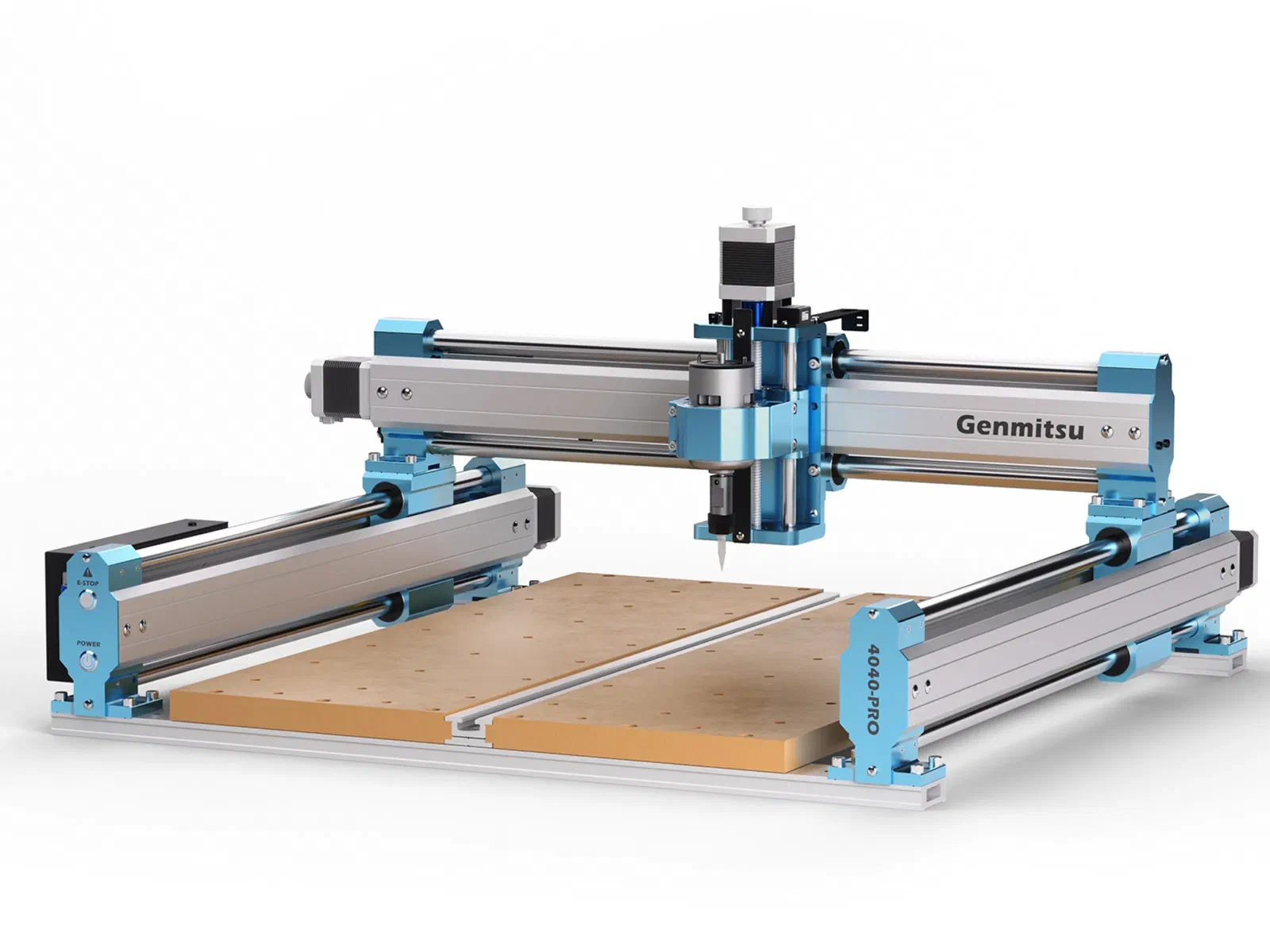

About the Machine
The Genmitsu 4040-PRO has a 400 x 400 x 78 mm working area, a 75W spindle (upgradable), and NEMA17 stepper motors on a lead screw drive.

The 4040-PRO's 75W spindle doesn't have a published max RPM, so check the spindle's plate before assuming it matches the chart. Depth per pass is where the machine itself matters. A truly rigid machine with a powerful spindle can cut as deep as the bit is wide in a single pass, but that takes real spindle torque, a drive train and clamps that hold firm, a gantry that will not flex, and enough mass to soak up vibration. This is a light desktop machine on a lead screw drive, well short of that bar, so take shallower passes. Push too deep and the bit deflects and chatters, leaving scalloped edges, or it rubs instead of cutting and burns the material. The fastest way to dial in a cut is to see what has already worked for other people.
Worked example for feed rate: 1/8in (3.175mm) two-flute solid carbide end mill in hard wood. The chart says 16,000 RPM; Sainsmart does not publish a max spindle RPM for this model, so check the spindle's plate for its actual ceiling and use the lower of the two. With the bit maker's 0.025mm per tooth (0.0010 in): 16,000 x 0.025 x 2 = 800 mm/min (31 in/min) feed, adjusted down if your spindle's plate shows less. For depth per pass, start shallow and check Community Cut Settings in Easel for what works on this machine. If the cut sounds strained, reduce the depth, not the feed. Slowing the feed below the chip load makes the bit rub instead of cut.
