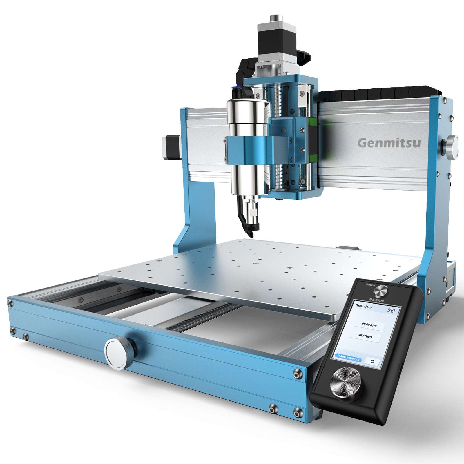

The Genmitsu 3030-PROVer MAX has a 300 x 300 x 78 mm working area, a 300W spindle (48VDC), and 1.68 A stepper motors (0.45 Nm torque) driving an HG15 linear guide and ball screw.

The 3030-PROVer MAX's 300W spindle doesn't have a published max RPM, so check the spindle's plate before assuming it matches the chart. Depth per pass is where the machine itself matters. A truly rigid machine with a powerful spindle can cut as deep as the bit is wide in a single pass, and that takes real spindle torque, a drive train and clamps that hold firm, a gantry that will not flex, and enough mass to soak up vibration. HG15 linear guides and a ball screw drive put this machine closer to that standard than SainSmart's lead-screw kits, so you can push somewhat deeper passes, but still watch for chatter rather than assuming full bit-width depth. Push too deep and the bit deflects and chatters, leaving scalloped edges, or it rubs instead of cutting and burns the material. The fastest way to dial in a cut is to see what has already worked for other people.
Worked example for feed rate: 1/8in (3.175mm) two-flute solid carbide end mill in hard wood. The chart says 16,000 RPM; SainSmart does not publish a max spindle RPM for this model, so check the spindle's plate for its actual ceiling and use the lower of the two. With the bit maker's 0.025mm per tooth (0.0010 in): 16,000 x 0.025 x 2 = 800 mm/min (31 in/min) feed, adjusted down if your spindle's plate shows less. For depth per pass, start shallow and check Community Cut Settings in Easel for what works on this machine. If the cut sounds strained, reduce the depth, not the feed. Slowing the feed below the chip load makes the bit rub instead of cut.
