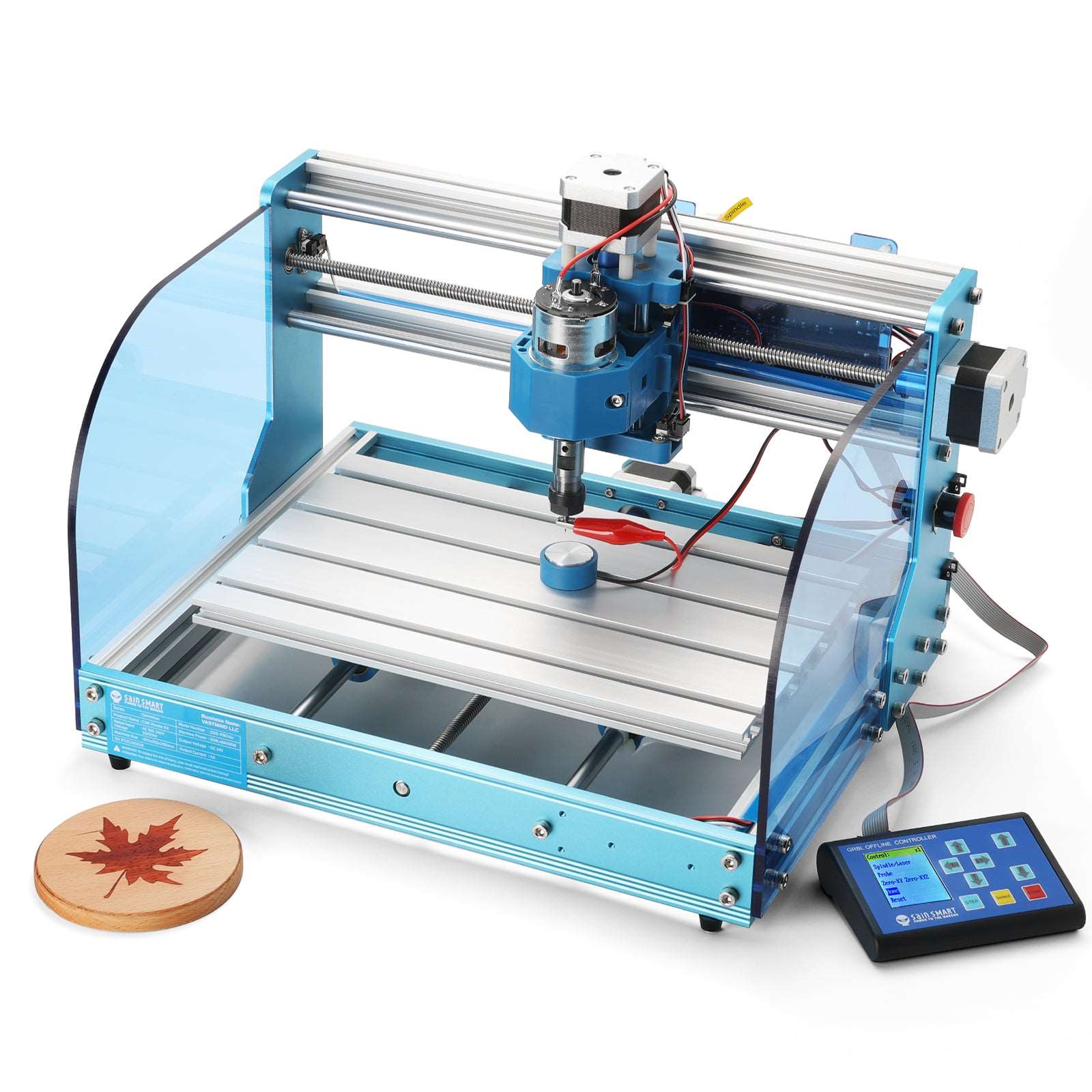

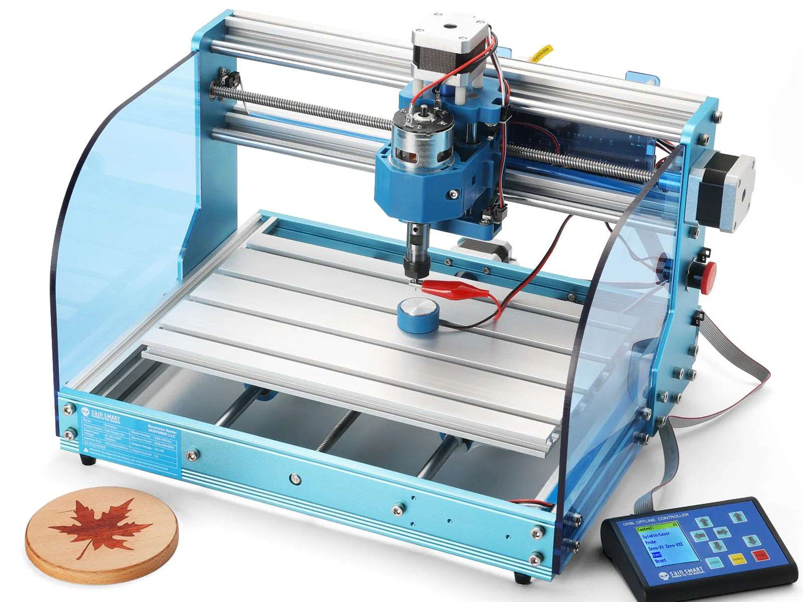

Sainsmart Genmitsu 3018-PROVer machine photo
About the Machine
The Genmitsu 3018-PROVer has a 260 x 155 x 35 mm effective working area, a 775 spindle (60W rated, 10,000 RPM), and 1.3 A stepper motors (0.25 Nm torque).
