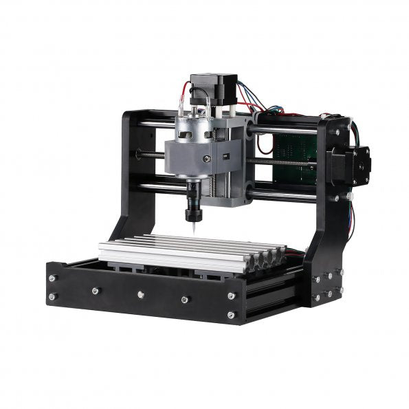

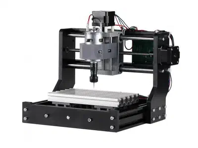

Sainsmart Genmitsu 1810-PRO machine photo
About the Machine
Sainsmart no longer sells this model, but it remains fully supported in Easel. The Genmitsu 1810-PRO has a 180 x 100 x 45 mm effective working area, a 775 spindle (60W rated, up to 9,000 RPM at 36V), and 1.3 A stepper motors (0.25 Nm torque).

Quick Specs
Cuttable Area
180 x 100 x 45 mm (7.1 x 3.9 x 1.8 in)
Spindle Power
Stepper Motors
1.3 A, 0.25 Nm
Drive System
Controller
GRBL
Connectivity
USB
