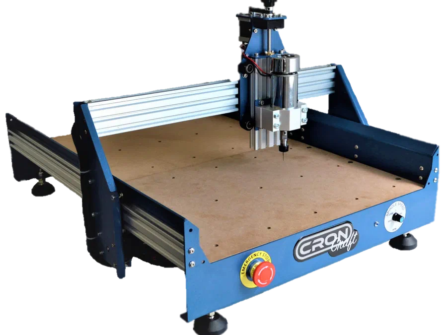

The CRON Craft Small is the most compact CRON Craft Station, with a 400 x 250 x 50mm working area. It runs the same 12,000 RPM air-cooled spindle as the rest of the line at up to 3000mm/min (118 in/min) feed rate, weighs 13.1kg, and connects over USB with GRBL control. CRON does not publish a spindle wattage, stepper motor spec, or drive system for this machine.
