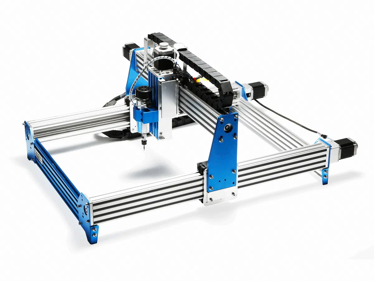

SainSmart Genmitsu PROVerXL 4030 (6060 Expansion)
PROVerXL 4030 fitted with the 6060 expansion kit
Use with Easel Pro →
About the Machine
The Genmitsu PROVerXL 4030 (6060 Expansion) pairs a base PROVerXL 4030 with SainSmart’s 6060 XY-Axis Extension Kit and 6060 Hybrid Table to reach a 600 x 600 x 110 mm working area. It uses the base machine’s 300W spindle and NEMA23 stepper motors on a V-wheel rail with lead screws.
