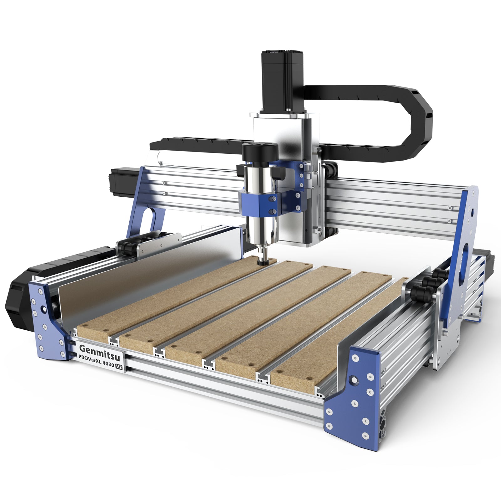

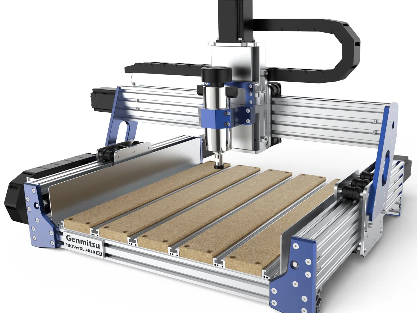

About the Machine
The Genmitsu PROVerXL 4030 V2 has a 400 x 300 x 110 mm working area, a 400W spindle (10,000 RPM), and closed-loop NEMA23 stepper motors (76mm) on a 1204 ball screw drive.
