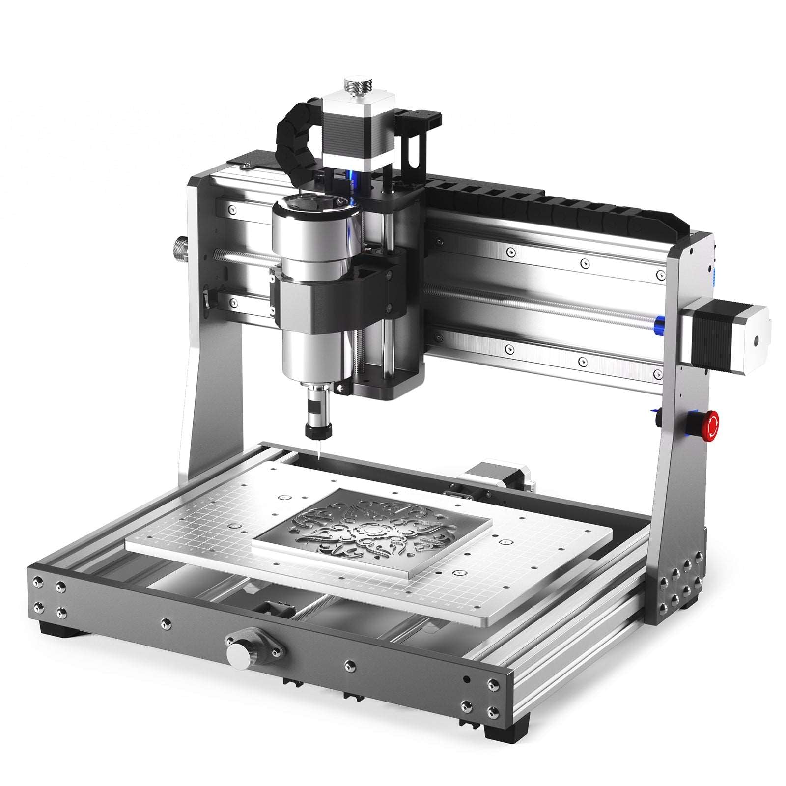

A SainSmart Genmitsu 3020-PRO MAX V2 CNC machine.
About the Machine
The Genmitsu 3020-PRO MAX V2 has a 300 x 205 x 78 mm working area, a 300W spindle (52mm diameter), and NEMA17 stepper motors (48mm) on a dual steel X-axis guide rail.
