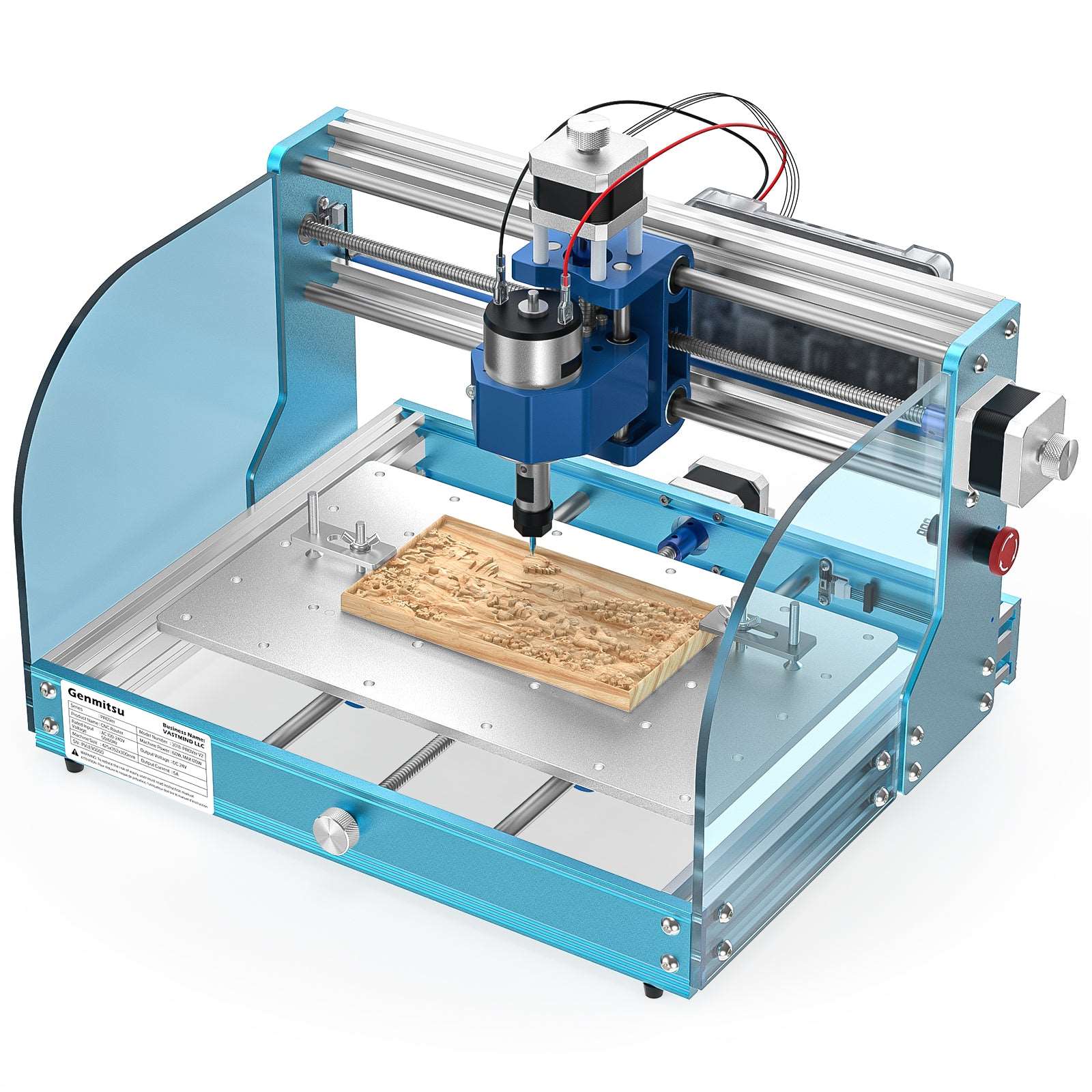

A SainSmart Genmitsu 3018-PROVer V2 CNC machine.
About the Machine
The Genmitsu 3018-PROVer V2 has a 290 x 180 x 40 mm working area, a 775 spindle (10,000 RPM), and 1.3 A stepper motors on V-slot linear rails.
