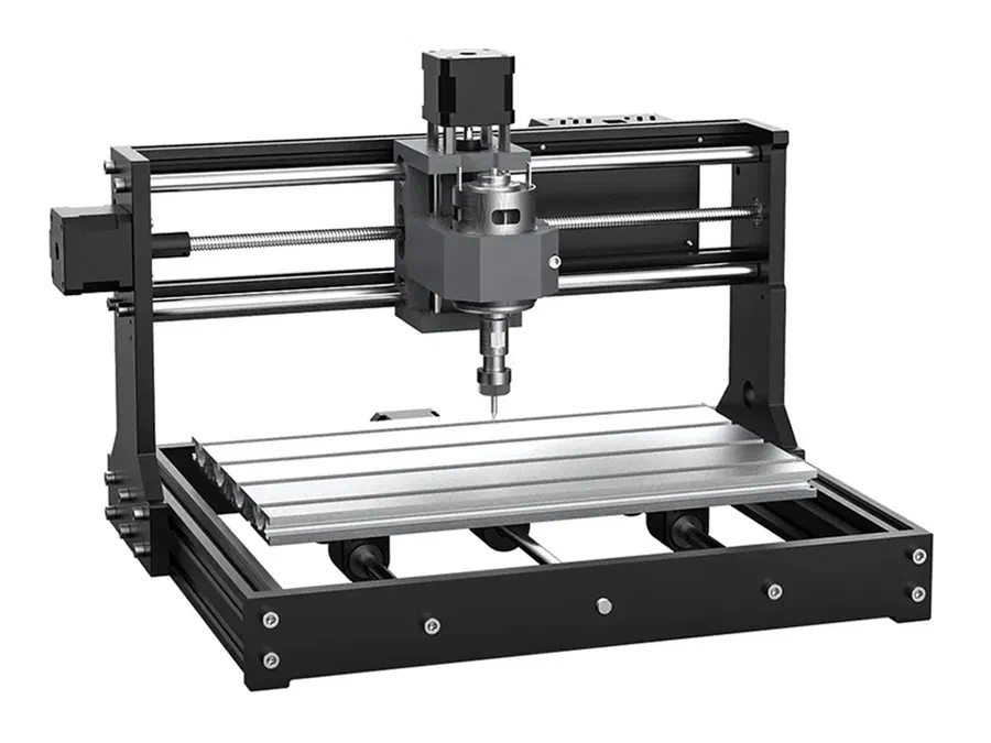

A DIY CNC 3018 CNC machine.
About the Machine
This Easel menu entry covers the many white-label 3018-class CNC machines sold under dozens of different brand names, most sharing nearly identical mechanics from the same handful of factories. There is no single manufacturer behind the ‘3018’ name, so no exact spec can be validated against an official source for this entry. Machines in this class typically share a working area around 300 x 180 x 45 mm and run a GRBL controller, but the exact numbers vary by seller, so check your own machine’s listing or manual before relying on any figure here.
