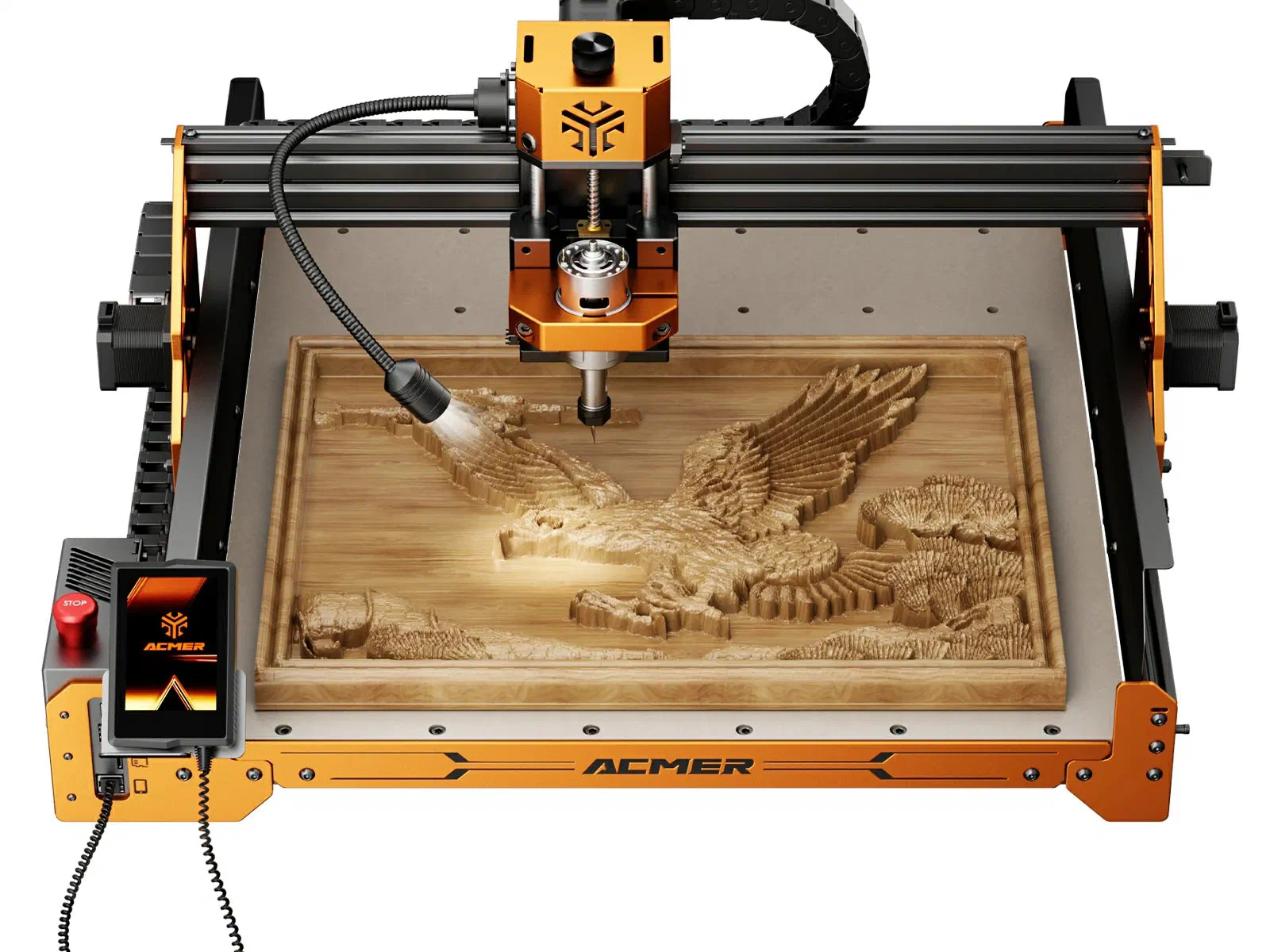

About the Machine
The ACMER ASCARVA 4S is a pre-assembled CNC router with a 70W spindle standard, upgradeable to 500W, controlled from an onboard 3.5 inch touchscreen with a manual Z-knob. ACMER Manual V1.2 lists a 400 x 400 x 80 mm working area (15.7 x 15.7 x 3.15 in). It runs the X and Y axes on GT2 6 mm timing belts with steel V-wheels and the Z axis on a lead screw, and supports 5W and 10W laser modules, so the same frame can also run as a laser engraver.
