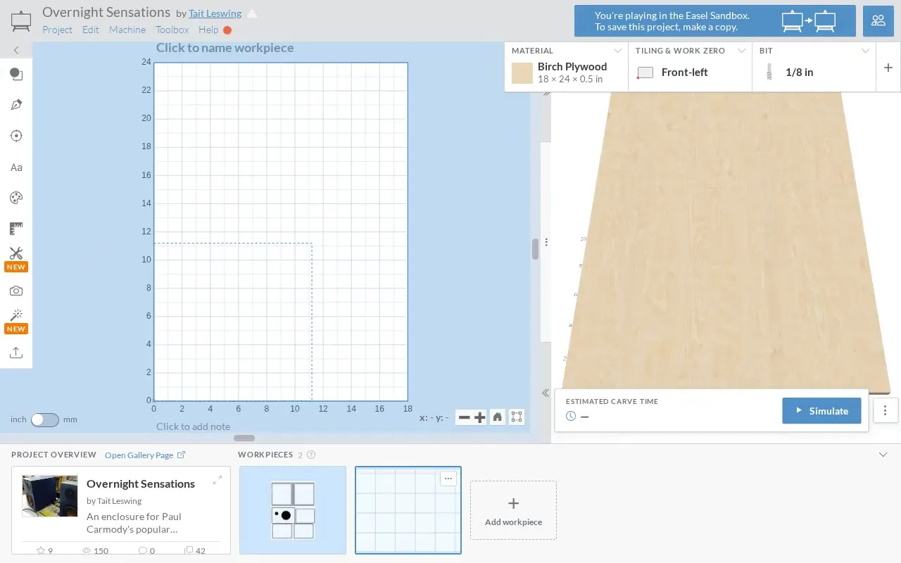

Draw a front panel with two speaker openings
Start with a blank workpiece in the real Easel editor. Add a square, change it to an 8-by-6-inch rectangle and choose an outside outline cut. Add two circles, set their sizes and positions, then give them a depth that reaches through the stock. The 3D preview shows the openings. The 3-inch and 1-inch circles demonstrate the controls, not dimensions for a particular speaker. Use the mounting drawings for your own drivers before sizing the holes. This is a front-panel layout, not an acoustic enclosure plan or a cutting setup.
A blank Easel workpiece gains a rectangular speaker-front outline and two round openings, with the native 3D preview beside it.
Recorded in the Easel editor, shown at 3× speed.

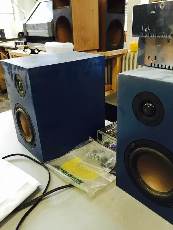

Carve a compact case or cut panels for bookshelf speakers
A small desk speaker and a pair of workshop speakers need different cases. These builds show layered shapes and flat panels. The shared files cover woodworking parts; speaker drivers, wiring and assembly are separate.

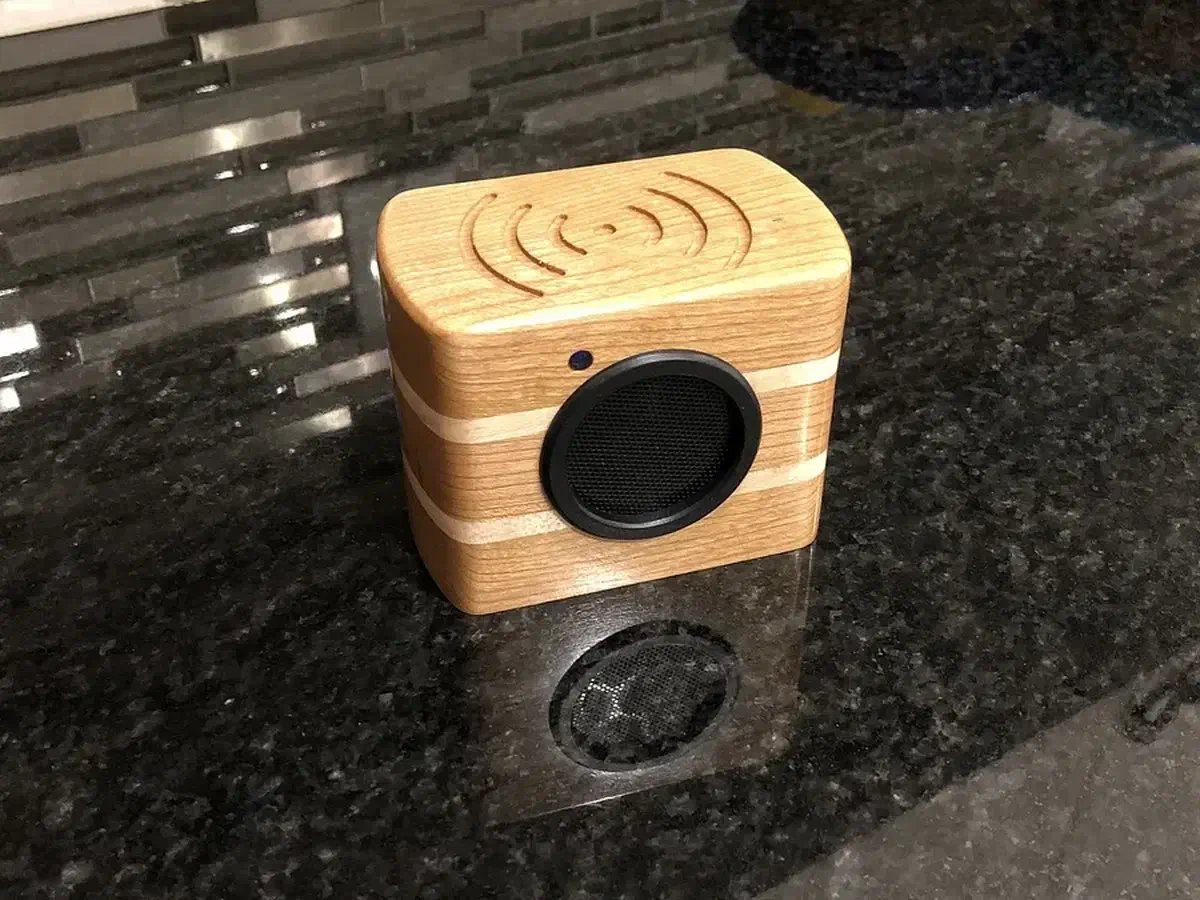

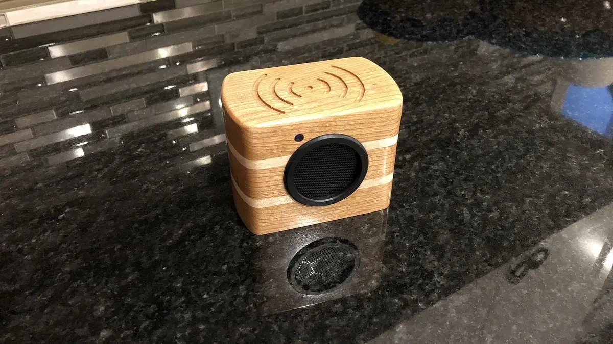

A small wooden speaker with a dark round grille and a pale stripe standing on a dark countertop Bluetooth Speaker with Wireless Chargerby Joseph Van Beckum
Van Beckum combines cherry and maple in a compact desk speaker with a charging surface on top. Six shared workpieces include the middle ring, top, charger pocket, decorative waves, bottom pocket and cover. The front speaker opening and complete assembly are separate work shown in his build video. Follow that build alongside the shared parts rather than treating the file as a complete box plan.
