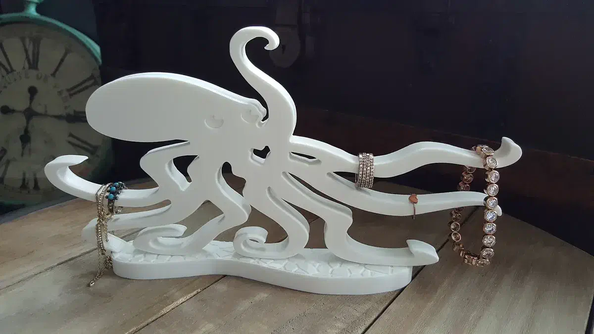

Jules used a 1/16-inch fishtail bit for the octopus outline but found its cutting length short for half-inch Corian. A 1/8-inch bit can reach through the material more easily, though it will lose some of the small outline detail. Check both the cutter diameter and its usable cutting length when you adapt this design.
Comment by Jules: read the source.
From Octopus Jewelry Stand by Jules.

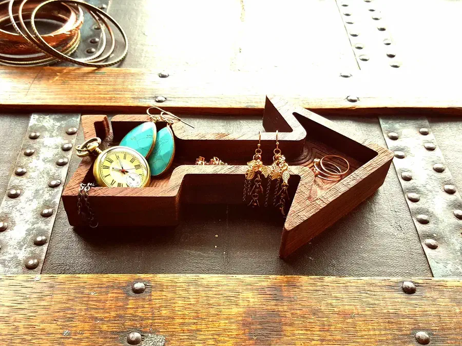

Sand the arrow dish’s seam after the glue dries
Jules lets the glue dry before sanding the join between the arrow dish’s rim and base. Smooth that seam and any rough edges before applying the mineral-oil finish. The joined dish needs this finishing step even though each layer has already been carved.
Project notes by Jules: read the source.
From Rustic Arrow Dish by Jules.
