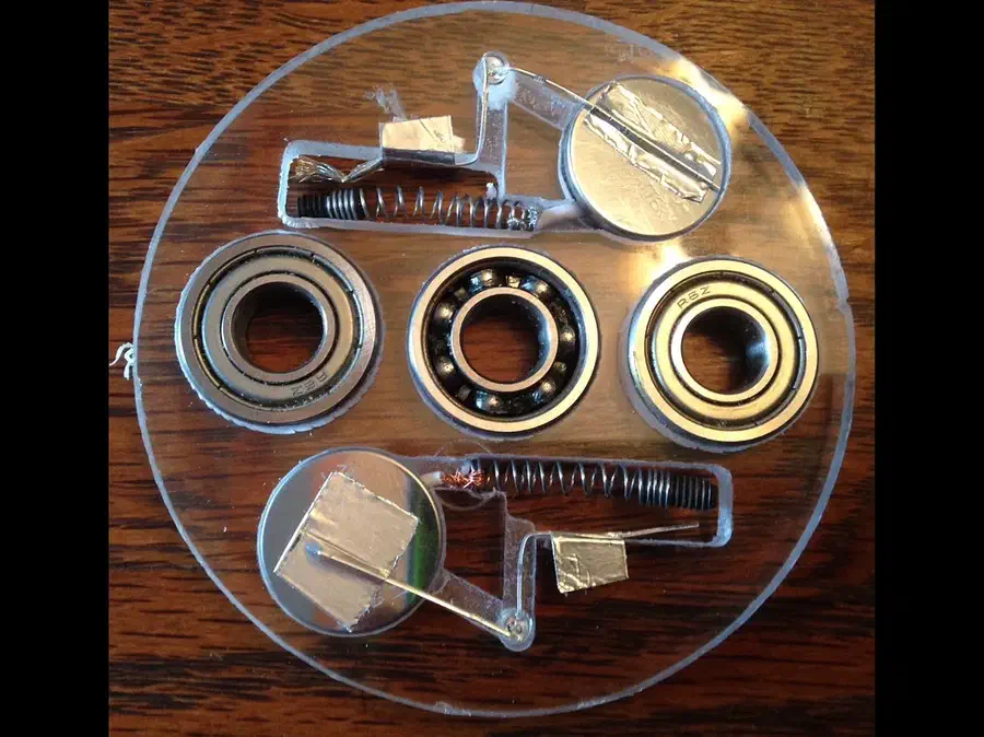

Make cover openings match the bearing thickness
Yahr’s bearings were thicker than his acrylic center plate, so he added openings in the back cover for them. He says thicker acrylic can remove the need for the two outer openings. Compare the actual plate and bearing thicknesses before deciding which covers to cut.
Project notes by Gary Yahr: read the source.
From LED Fidget by Gary Yahr.
Ask a question
Test the circuit before fitting the covers
Yahr installs the battery and tests the LED before closing the spinner. Keep the cover off while checking that the spring’s weighted end moves freely and the light turns on when spun. That sequence leaves the switch accessible if its fit needs adjusting.
