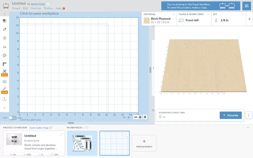

Draw a rail with a slot for folded arms
Start with a blank workpiece and size a rectangle to 7 by 1 inches. Give the outer shape an outline cut, then add a 6-by-¼-inch rectangle inside it for a through slot. Watch the real Easel editor and 3D preview update. This shows the basic rail shape; adjust the slot around your glasses and plan the rear mounting separately. The recording uses the preview’s 0.2-inch stock, not a finished mounting or cutting setup.
A real blank Easel workpiece gains a rectangular glasses rail outline and a long through slot beside the native 3D preview.
Recorded in the Easel editor, shown at 3× speed.

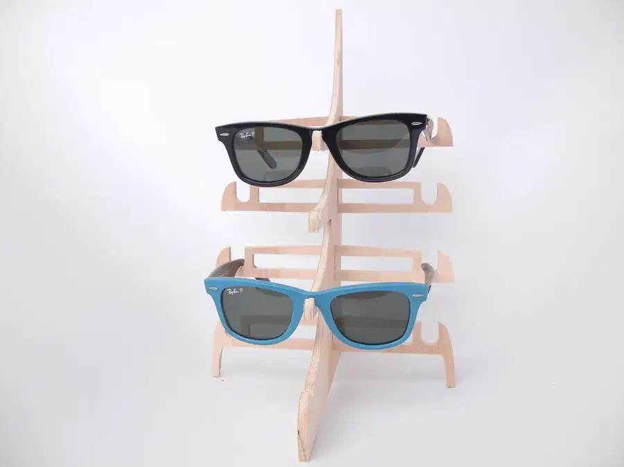

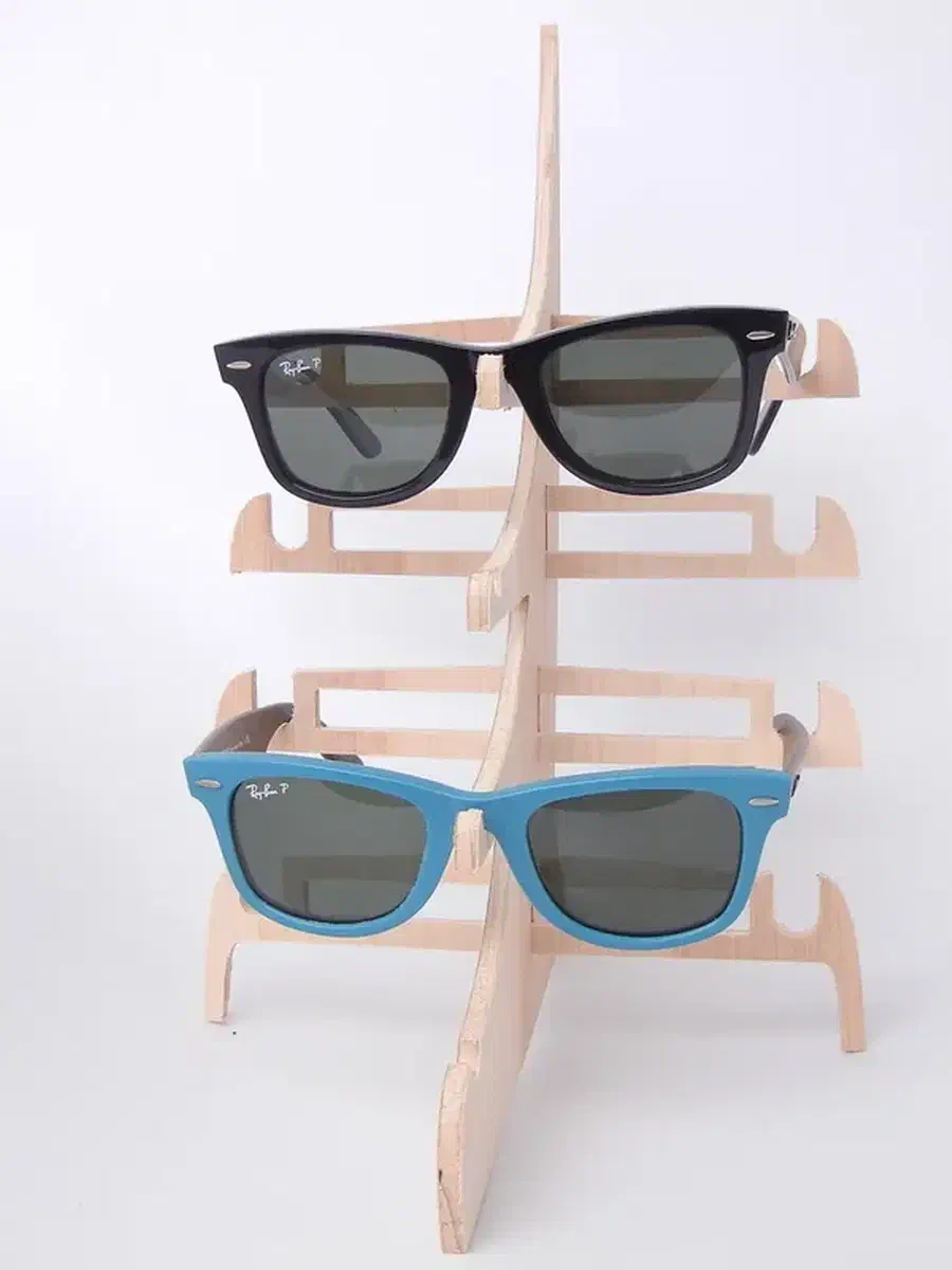

Jones designed the stand around plywood that measured about 0.2 inch, even though it was sold as quarter-inch stock. Use the measured thickness when adjusting the interlocking slots. A small test joint in a scrap lets you check the fit before cutting all the arms.
Project notes by aaron jones: read the source.
From Sunglasses Stand by aaron jones.

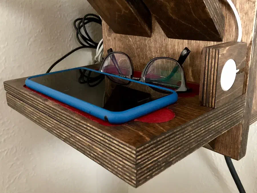

Brewer sands and stains the charging pad, then lets the stain dry overnight before flocking the pockets. If you want a lined glasses recess, follow that order so the wood finishing is complete before the fibers go in. The lining is optional.
Project notes by Nick Brewer: read the source.
From iPhone 8 Plus Charging Pad by Nick Brewer.
