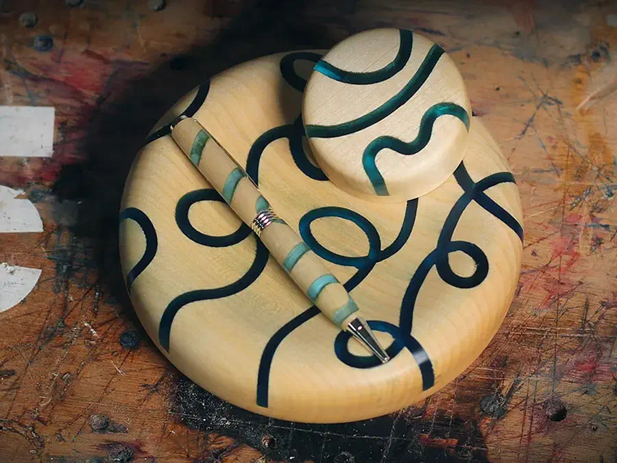

Wood and epoxy
Embed epoxy in wood to create tabletops, coasters, and decorative art.

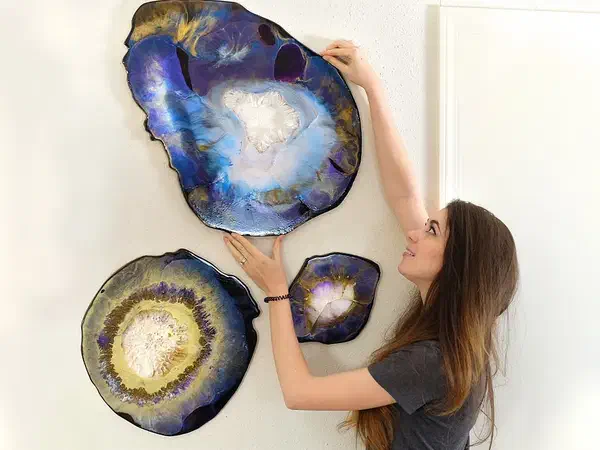

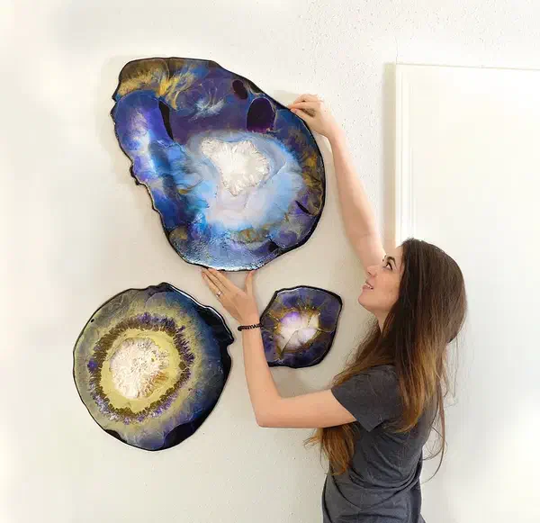

Explore CNC carving with epoxy: a state-outline inlay in a cutting board, red lettering on shop clamp racks, colorful geode wall art, blue oceans on a world map, a cast serving tray, and resin accents in turned wood.

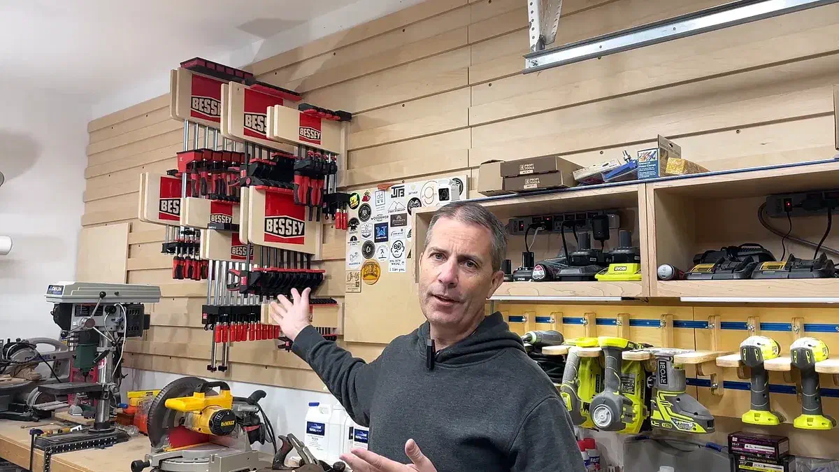

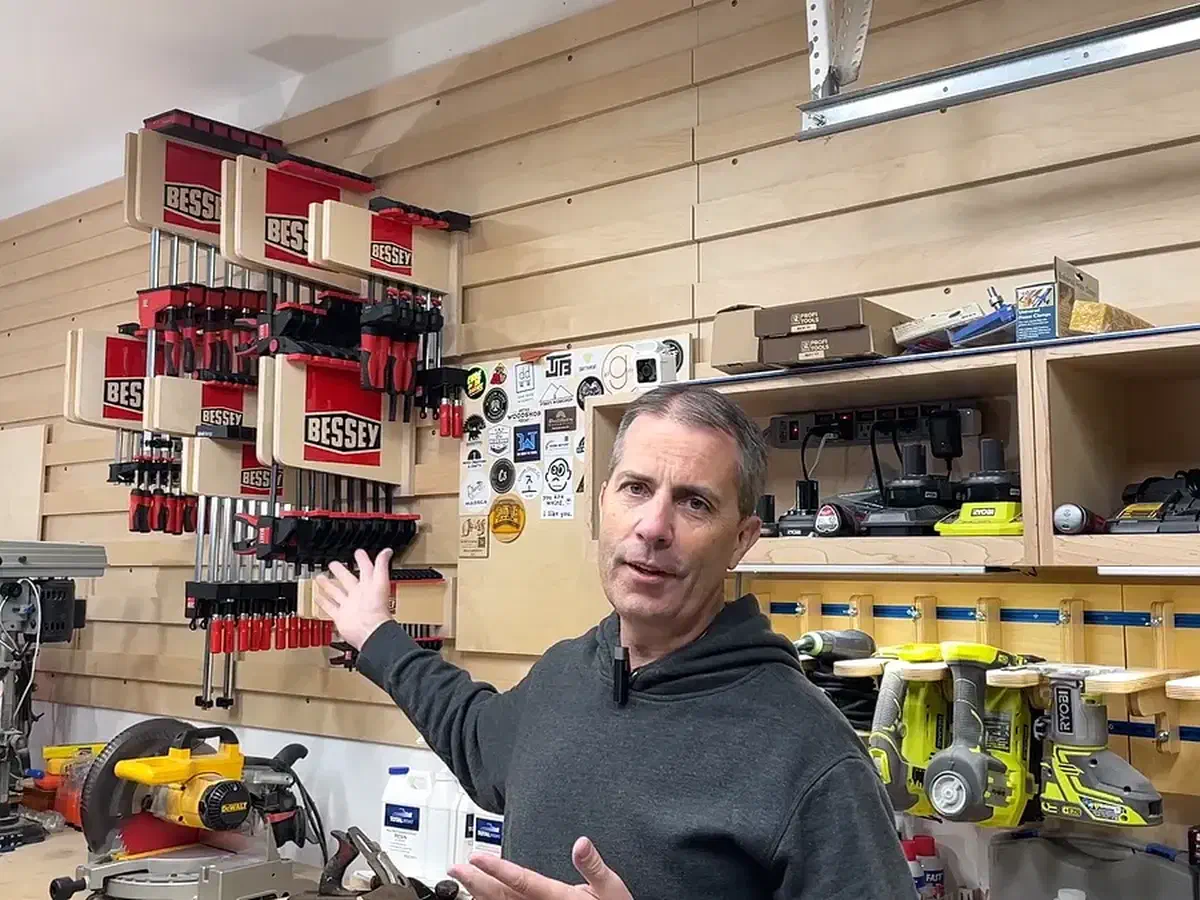

Fill height changes the look of V-carved lettering
Steve compared straight bits with a 60-degree V-bit for his Bessey logos. With the sloped V-carved sides, a shallow epoxy fill made the lettering look wider; a higher fill made it look narrower. He chose straight bits for a more consistent filled logo. He also noted play in his Z-axis during the V-bit test, so this was not a controlled comparison.
Project notes by Steve Moseley: read the source.
From Bessey Clamp Racks with Epoxy Logo by Steve Moseley.
Ask a question
Tint can travel beyond the carved pocket
Steve reports tinted epoxy traveling as far as two inches through wood outside a carved area, leaving discoloration he could not sand away. For his clamp racks, he applied two coats of water-based topcoat before the pour and kept the glue edges uncoated. That is his documented finish combination, not a compatibility guarantee for other resins and sealers.
Ask a question
