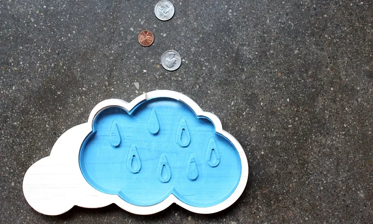

A blue cloud-shaped coin bank with a white border and raindrops, photographed with coins on a dark surface Cloud coin bankby Mo Stych
Cloud coin bank
Stych’s gallery photo shows a blue cloud bank with a white border. The shared Easel project demonstrates the same pocket-and-clear-face approach in a hen shape: its three workpieces supply the body design, acrylic oval and 1/4 inch back outline. Use those hen parts as your starting point, or draw your own cloud outline; the pictured cloud silhouette is not supplied. The project instructions link the Easel Live lesson.

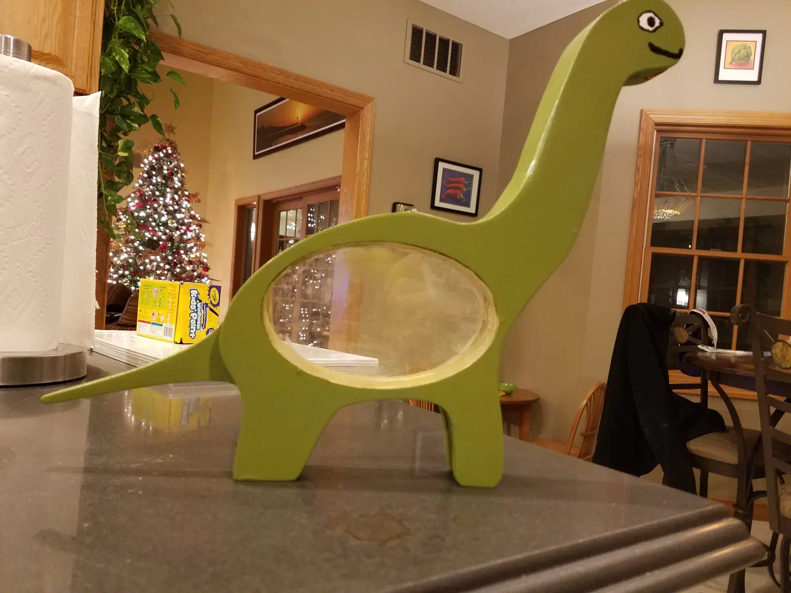

A painted green long-necked dinosaur coin bank with a clear oval belly standing on a kitchen counter dinosaur bankby James Mikeworth
Dinosaur bank
A long-necked dinosaur stands on its own feet with a clear oval belly. Mikeworth says he cut 1/2 inch plywood together, then glued, painted and sealed it. The single shared workpiece supplies body-and-leg profiles and oval pieces, not the pictured neck, head or tail. Start with the body parts and draw those extensions and the coin entry for your version.

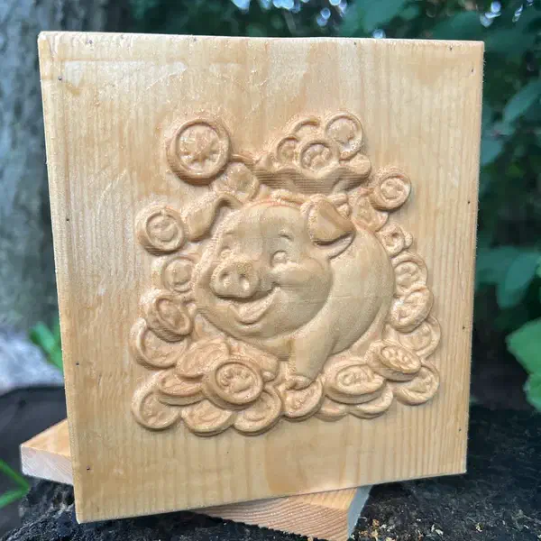

Check the finishing-pass time before enlarging a relief
Marcisz warns that a larger 3D carve can take a long finishing pass, and calls out bit step-over as part of that decision. Before scaling up a decorative bank front, compare the estimated carve time with the detail you want. A larger carving is not simply a larger box.
