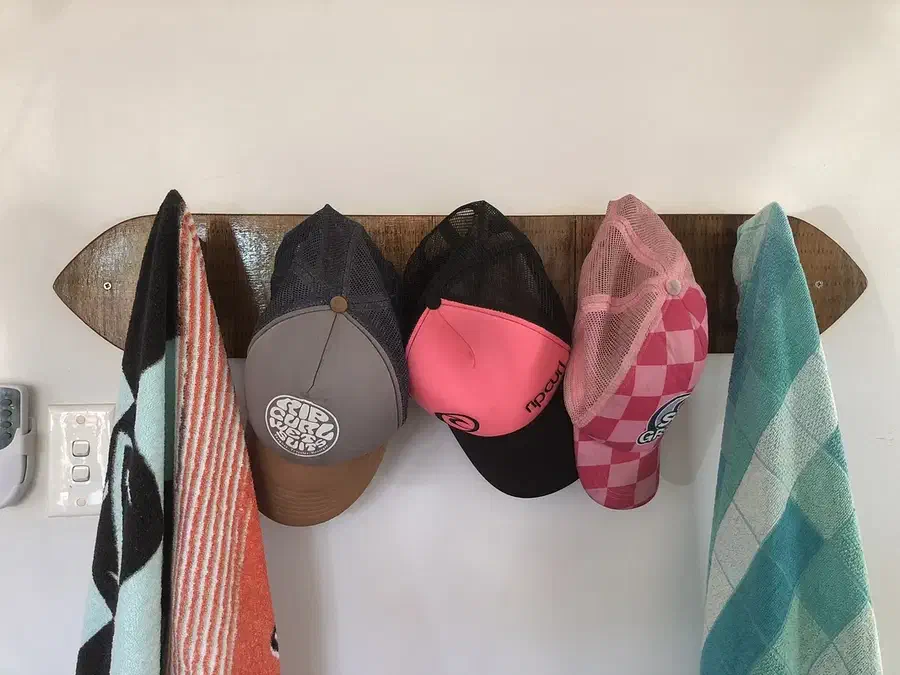

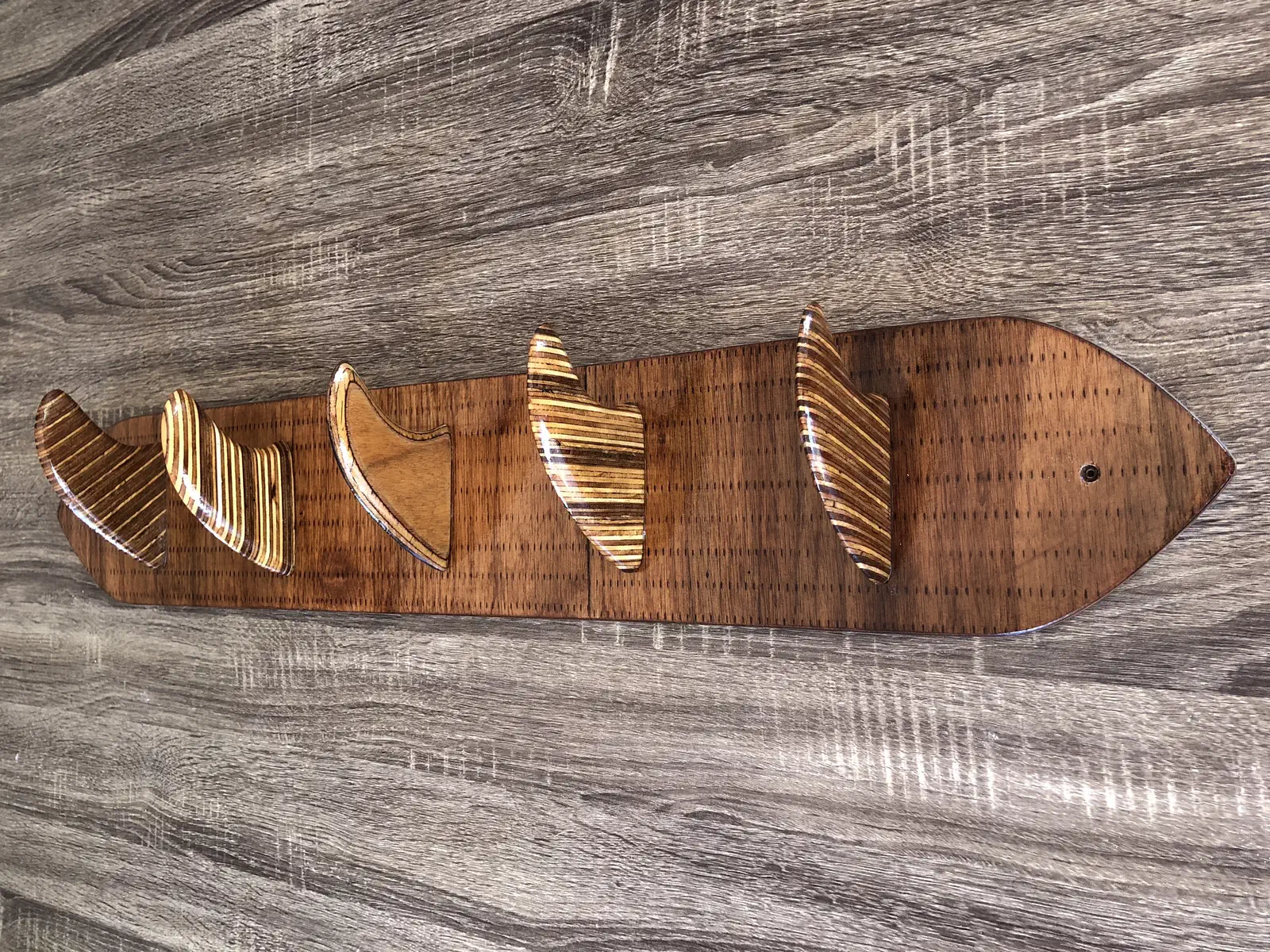

Round the fin edges after carving
Tonks sands the fins after cutting to give them a curved hydrofoil shape and expose the plywood layers. The flat outline is only the start of that rounded finish. He also specifies both glue and screws for joining fins to the backboard, then sealing the wood. Decide how you will shape and attach the hooks before choosing the board thickness.
Project notes by Gavin Tonks: read the source.
From Surf Towel/Hat/Bag/Coat/Key Rack by Gavin Tonks.

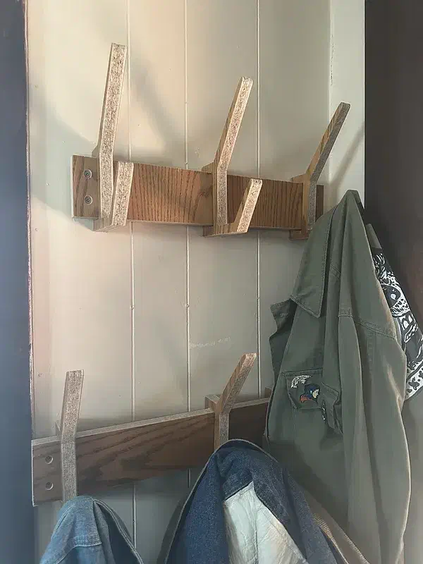

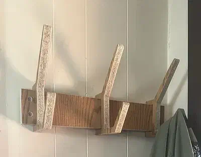

Keep X and Y fixed when changing rack operations
For his wood-and-wire racks, Burdett holds blanks in shallow fixture pockets and keeps the same X and Y origin through the sequence. He resets Z to the top of the blanks for slotting, then resets it again after changing to the keyhole cutter. That distinction matters when several operations share one fixture: preserve the horizontal reference while measuring each new tool's height.
Project notes by Ted Burdett: read the source.
From Wood and wire coat rack by Ted Burdett.
