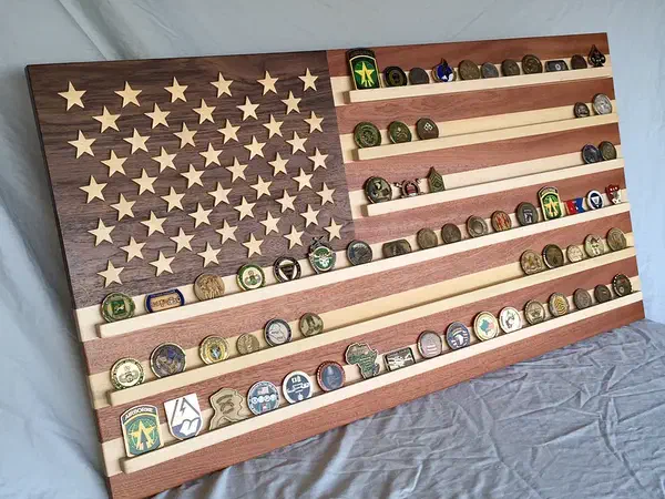

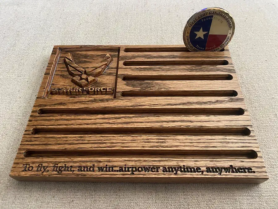

Hang the assembled coin rack with a rear cleat
Mike Merzke says his finished coin rack weighs about thirty pounds and hangs on a French cleat, so build in a cleat and solid wall anchors.
Comment by Mike Merzke: read the source.
From American Flag Coin Rack by Mike Merzke.

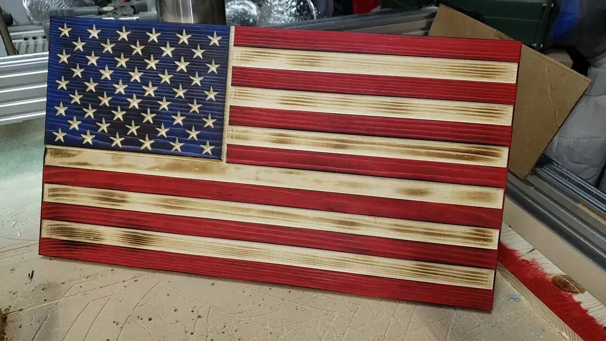

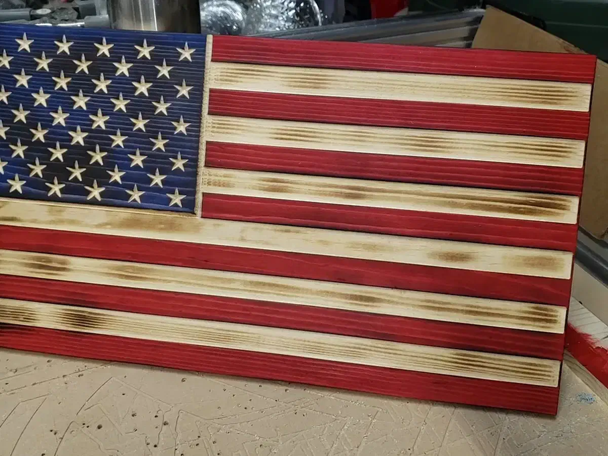

Stain the union and stripes before you carve
Stain the union blue and the stripes red, let it dry about fifteen minutes, then carve the stars, stripes and perimeter.
Project notes by SethCNC: read the source.
From American Flag with Video Tutorial by SethCNC.

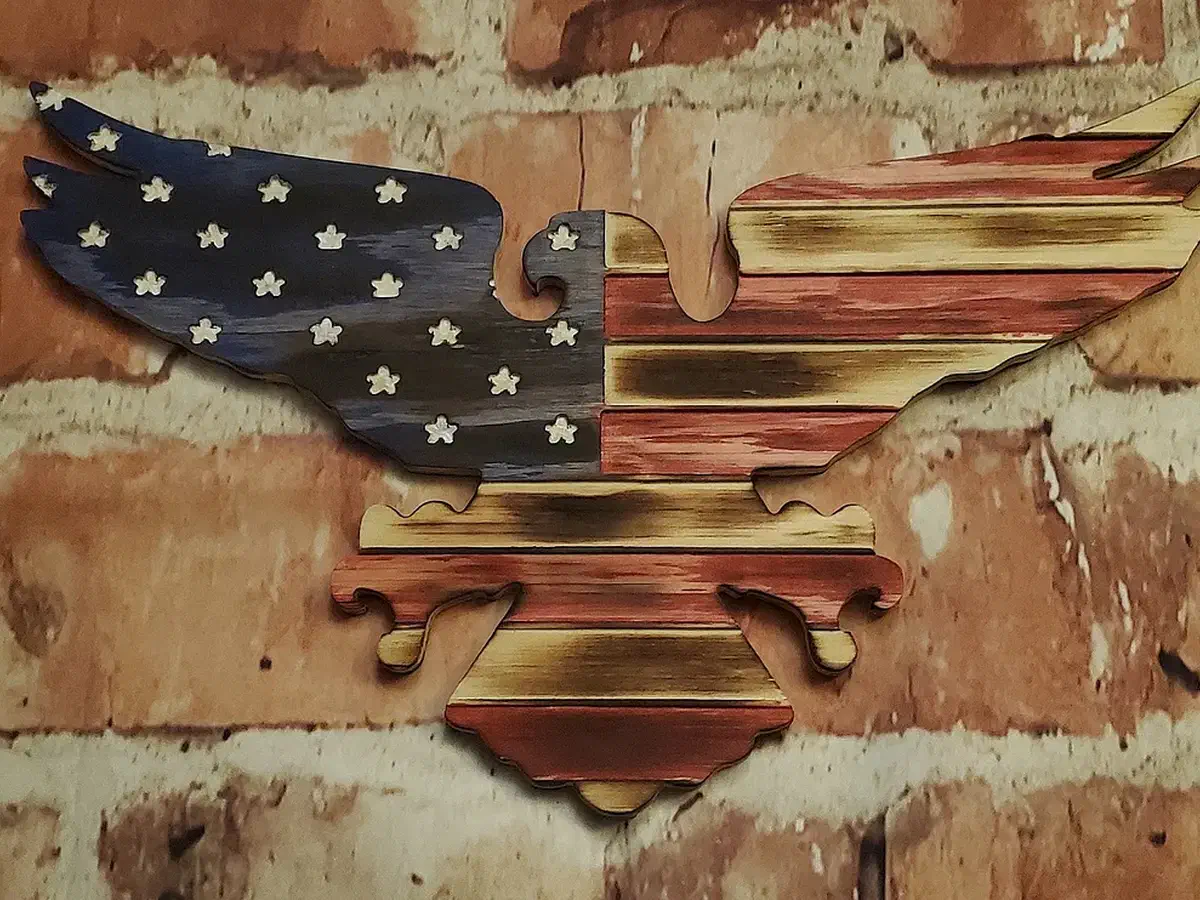

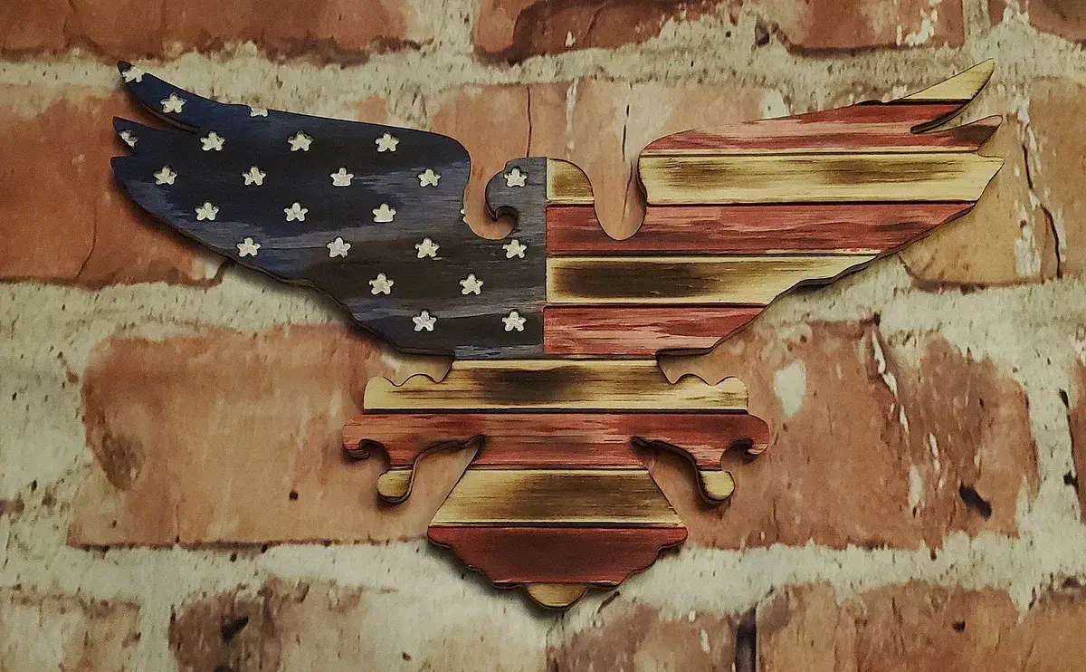

Cut the eagle outline last
Carve the flag workpieces first, then run the last one to cut out the eagle shape.
Comment by john metcalf: read the source.
From American Eagle Flag by DENNIS BERRY.
